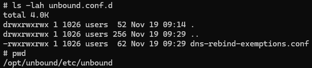

Run from within your unbound container, what's the output of:
ls -lah /etc/unbound/unbound.conf.d/
The path seems to differ a bit. My unbound is located in opt/unbound:
That could suggest that the container creators chose to deviate from unbound's package defaults when creating their unbound Docker image.
In that case, you'd have to consult your unbound container's documentation on how to apply custom configuration files.
But you haven't run the command as requested, instead opting to show me where you've created your file.
What does my ls command return?
It returns
Which was why I moved to the directory where I actually created the file.
Just to be sure, that was run from inside your unbound container?
Yes. I run a Synology NAS with its Container Manager. I used
to use your command inside the shell of my container "unbound".
That would confirm then that your unbound container is applying its own configuration, deviating from package defaults.
Note that there is no official unbound Docker image, so you are using some third-party invention.
As I have no knowledge about that container, I can't help you with that. :frowning:
