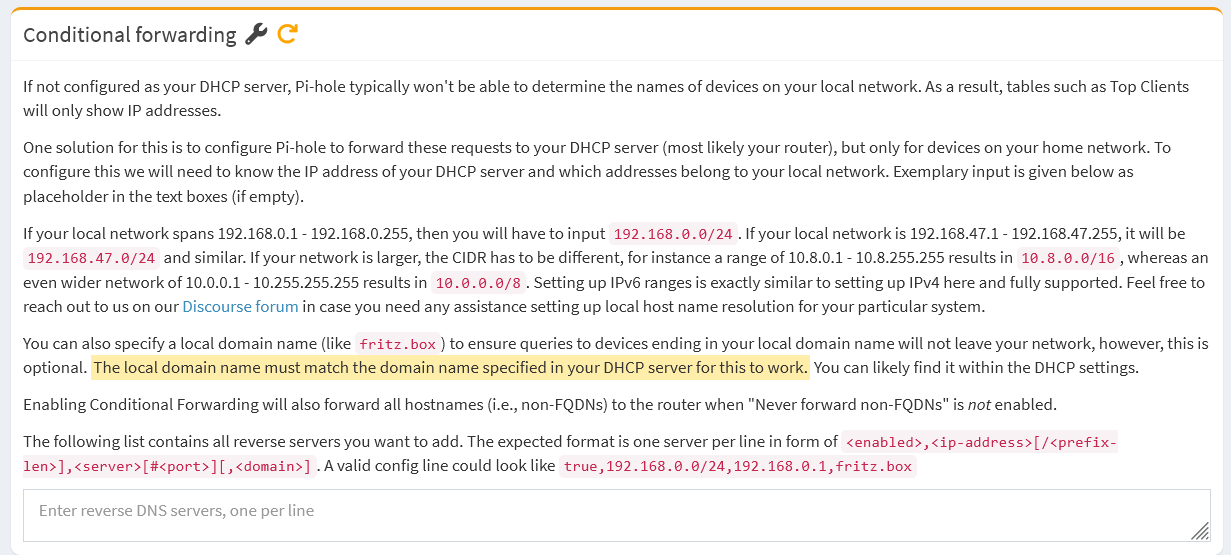

If you're router is doing DHCP services, you can let Pi-hole discover hostnames for known client IP's via conditional forwarding (revServers):
But make sure you dont close a DNS loop where the router returns queries back to Pi-hole!

I followed the instructions at Configuration - Pi-hole documentation so I assume conditional forwarding is enabled.
  revServers = [
    "true,192.168.1.0/24,192.168.1.1,openwrt"
  ] ### CHANGED, default = []

Your revServers option is configured to use openwrt domain, but your network is using lan as domain.
Is your router using lan or openwrt?
Did you try using lan ("true,192.168.1.0/24,192.168.1.1,lan")?

As noted above ^, the DNS search/suffix domain names must match.

Ah, I see! I was not clear on exactly what I was supposed to put for “domain”. In retrospect, it’s obvious. Thank you!
