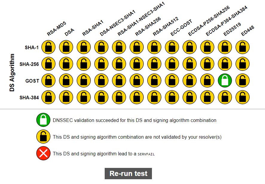

better security when visiting https://rootcanary.org/test.html
lots of unlocks on page, other posts I have seen have lots of locks, unsure what to do.
running FTLDNS with unbound on a pi2 raspbian stretch. router is a DD-WRT installed Linksys EA8500.

Yes, followed that guide, it's how i got unbound installed. DNSSEC passes.however, from what I gather, unbound isn't verifying certification, so theoretically you can spoof the certificate and dnssec will be useless

unfortunately no, and neither did a DNS flush. DNSSEC is enabled and working.
