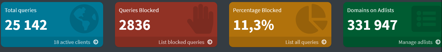

I have installed Unbound and notice rapid decline in DNS requests - from nearly 100k/day and 45% blocked to 25k/4 days (for now) and 11% blocked.
Is this normal? This is because Unbound working properly?

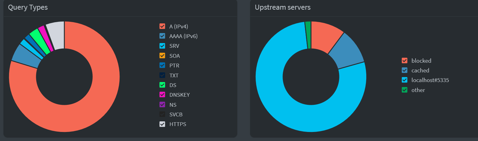

It's strange, because two clients of my network - business laptop and tablet - usually generating 10x more DNS requests, and today is as on the pictures.. I don't understand, because I've change only two things - installed Unbound and i has switched out nightly restarts.

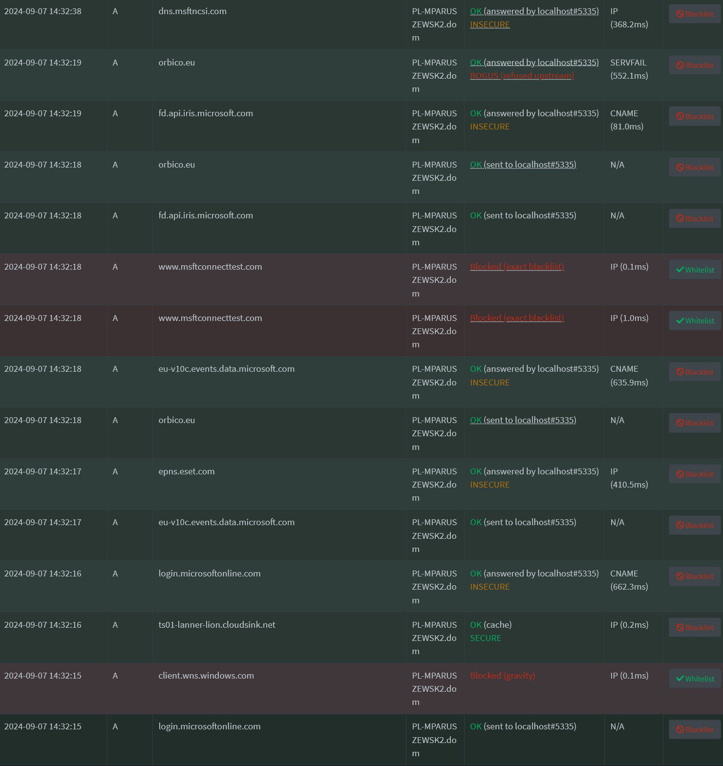

Look at this printscreen - it is one of two computers with the highest number of DNS req.
I think you are worried about the numbers, but apparently Pi-hole is working and blocking some queries.
Are you seeing ads in some of your clients?
I don't see much on that screen that would concern me.
Some of the queries are being blocked by Pi-hole, as expected.
Others are being forwarded to your local instance of unbound for resolution.
The concern is with the N/A replies.
For more details, take a look in the dnsmasq log at /var/log/pihole/pihole.log. That text file contains all the queries, forwards and replies.
In particular, take a look at the queries that don't receive a reply from unbound.
