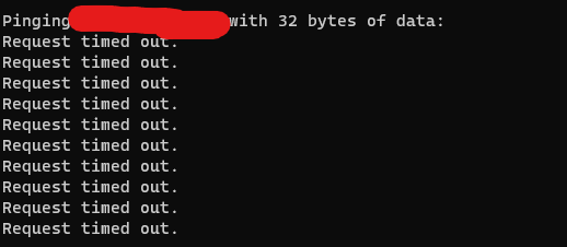

Unable to use ip as dns and pinging ip gives time out
Running on a AWS server with Ubuntu 20.04 LTS

If you are entering an IP and the other end doesn't respond to a ping, that's not a Pi-hole problem. Pi-hole had no involvement in that transaction.
You can verify this by repeating the IP ping and then checking your query log in Pi-hole. There should be no matching query.
Then what do I do? Just a noobie here trying to explore PI-Hole and maybe one day donate if it all works.
also currently pinging the IP and I'm seeing nothing in the logs.
The endpoint may not respond to pings. Not all endpoints do.
As I noted, this is not a Pi-hole issue, since your ping doesn't involve a DNS resolution.

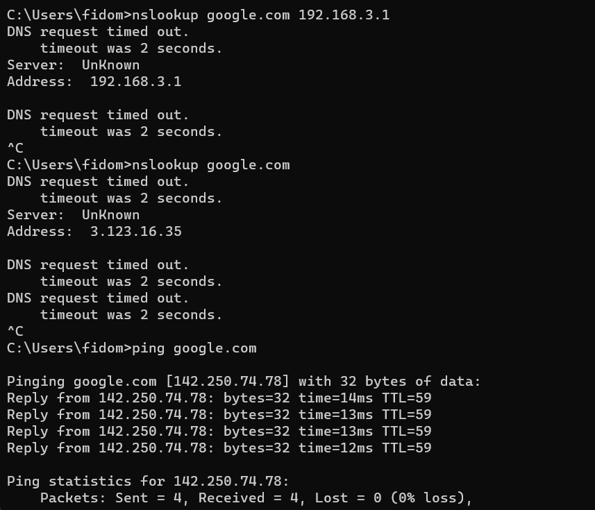

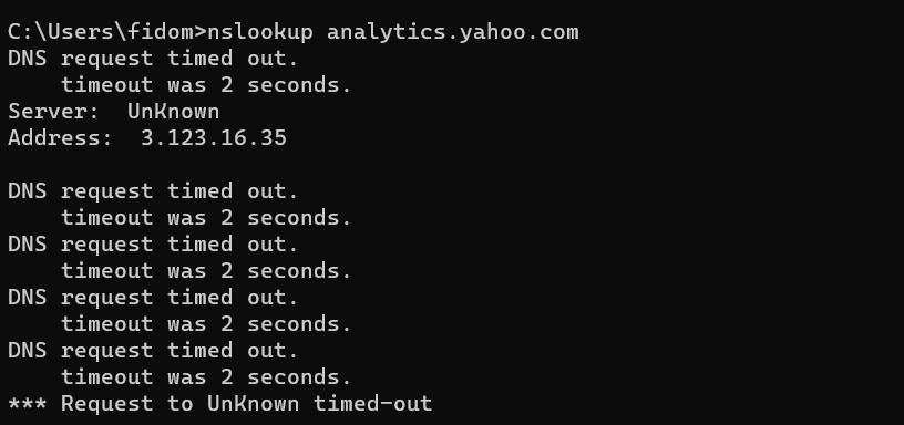

I tried completely reinstalling the server now, got to install pi-hole and it "works" my PC is using the IP as an DNS and I'm on the internet but when using nslookup command in cmd on domains I get a DNS timeout and when using the command ping it works fine, and it's showing nothing in the logs of me browsing the internet.
I'm using openDNS and also tried Quad9 DNS on the pi-hole in settings.
Again it's running on a AWS server with ubuntu 20.04 and I followed this guide: How to Setup Pi-hole on an AWS Instance – Mumble Grumble
Webdash also works perfectly fine.

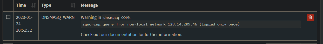

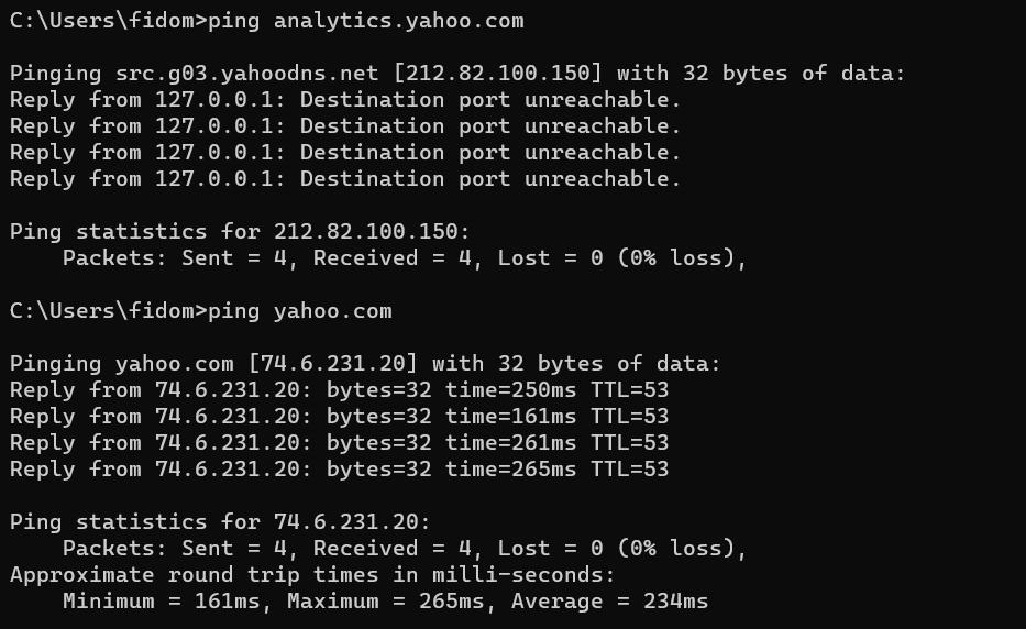

(Update it does filter as I tried to ping analytics.yahoo.com and it doesn't work but with a tor browser or other device I can reach analytics.yahoo.com, but it doesn't show anything in any of the logs on the PI-Hole. Also got this warning in the other logs)
Your above screenshot detailing that your Pi-hole is receiving requests from public IP addresses would suggest that you may be running an open resolver, which poses a potential threat for all Internet users, e.g. by serving as a multiplier in a DNS Amplification attack .
The Pi-hole team strongly discourages Pi-hole’s usage as an open resolver, and we won't provide support in that case.

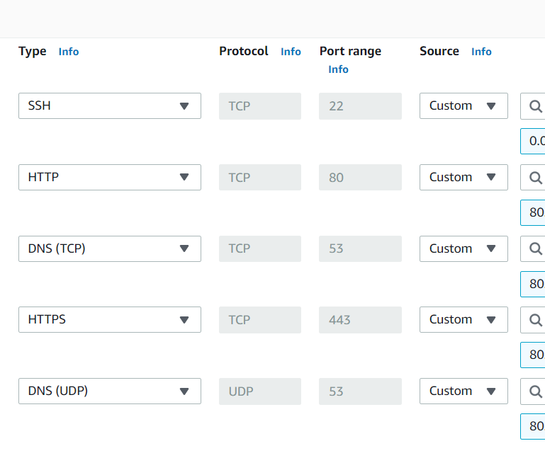

Oh, must be something with the security settings on AWS then, will try to limit it to my IP only. Thank you for giving me a heads up.
The proper way to integrate a cloud-based Pi-hole is via VPN, allowing secure access by authenticated clients only.
See the VPN section from Pi-hole's documentation (at Guides|VPN) for further suggestions, e.g. Redirecting....
I've now closed it to only my ip I hope.
