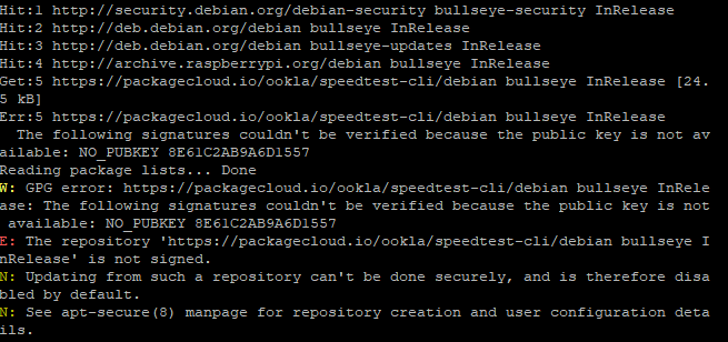

What was the complete output of sudo apt update?
Hello !
This:
You will want to clean up those errors so that apt update can complete with no errors. I would visit the forums for your OS.

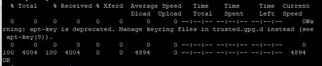

curl -L https://packagecloud.io/ookla/speedtest-cli/gpgkey | sudo apt-key add -
Result :
But it doesn't change anything...
You installed speedtest-cli from ookla, but the relevant keys for verifying the package repository is missing. You probably missed a step while installing. You need to make sure you have the relevant key or remove the package and repository from your source.list
