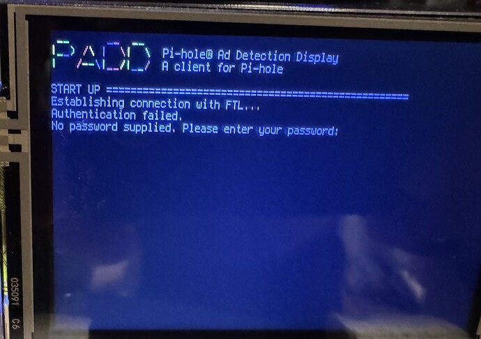

Hello together,
yesterday I have updates my rapberry pi 3B+ from PiHole5 to Pihole V6. Everthing works fine :slight_smile:
But the padd.sh (installed V4.0.0) shows me the following error message:
Hope you can help me.
Many thanks
Bart
This is not an error. PADD now requires your Pi-hole password to work.
many thanks, connected a keyboard and entered the passwort :slight_smile:
Normale I have no keyboard on the pi. Is there a other way to give the password inside a configurationfile?
You can pass it as argument ./padd.sh --secret <password>
perfect, many thanks
