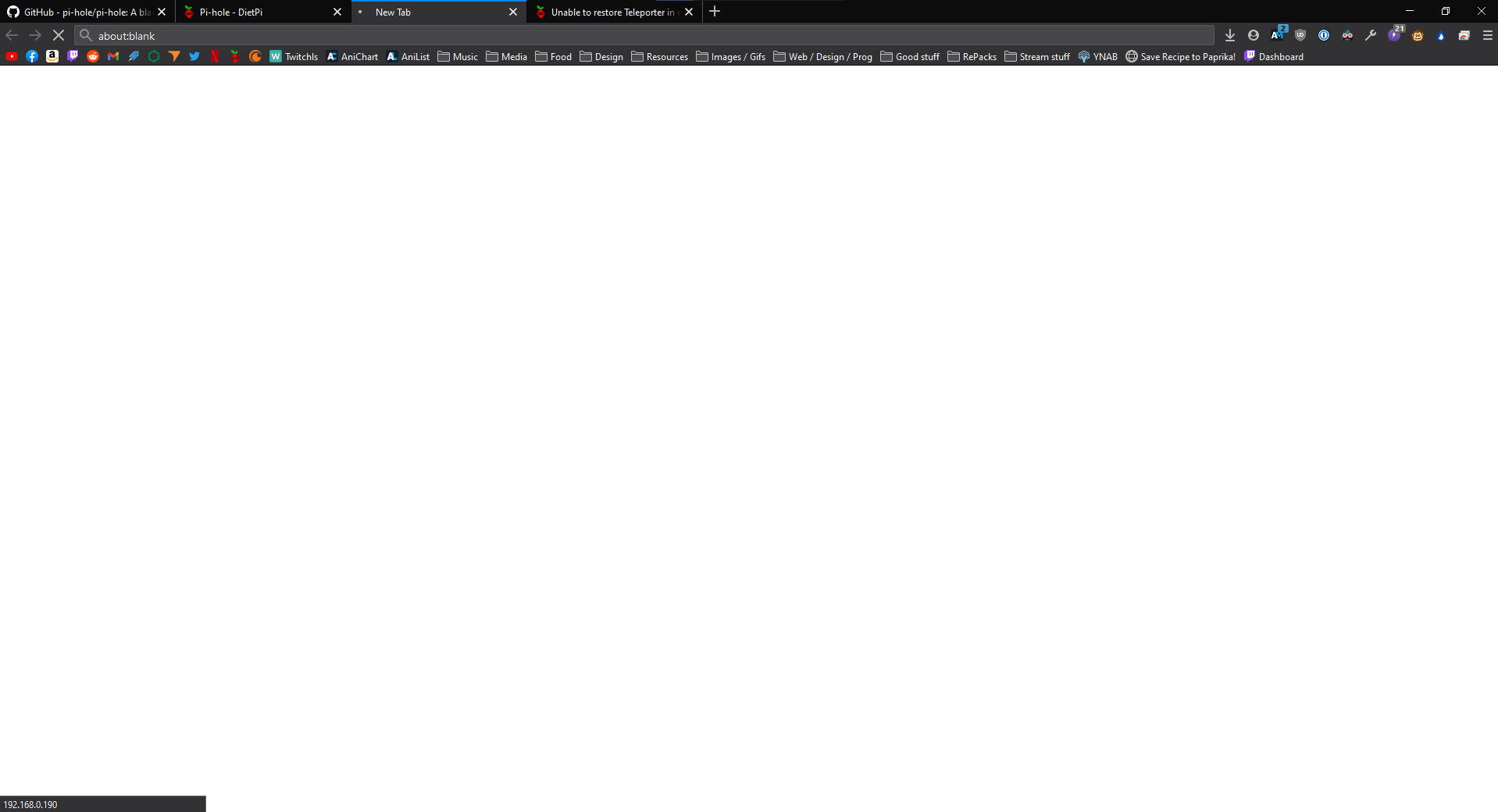

When restoring the Teleporter backup a new "about:blank" browser page opens and nothing happens. I am then unable to access the pihole admin portal and websites will be slow to load/sometimes unreachable.

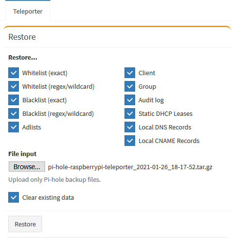

So I load my teleporter backup, I leave everything checked
Then when I hit "Restore" it opens a new page and even if I wait a while it stays there and nothing happens

I just tried in a fresh Chrome install and when I click on restore it opens up "http://192.168.0.190/admin/scripts/pi-hole/php/teleporter.php" and keeps loading.
