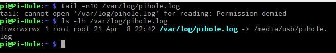

Permissions error. Attached screenshot.
Okay, all good so far. How about
ls -lh /media/usb/pihole.log
Okay, so this file can only be accessed by dnsmasq and root. Let me explain to you why:
rw- : user (dnsmasq) has read + write permissions
r-- : group (root) has only read permissions
---: All others (i.e. incl. you and the web interface) have absolutely no permissions on the file - not even read.
Adding read permissions to all users should solve your problems:
sudo chmod a+r /var/log/pihole.log
