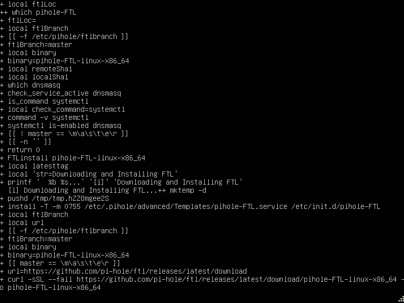

Then we will run the verbose version of the installer. Please post the output of the following, if Pi-hole fails to install.
Edited command:
curl -sSL https://install.pi-hole.net | sudo bash -x

That appears to be the output of the installer without the verbose option.
This is the output it's giving me with the -x as well, not sure why it's doing that.
Pardon me, that was my error. I omitted the required sudo. Run this instead:

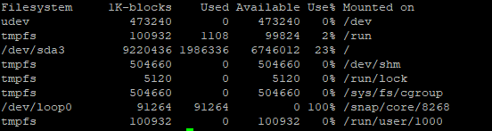

EDIT: Disk full maybe ?
df -h
No issues with disk, more than enough:
When I ran that command, it halted the system.
