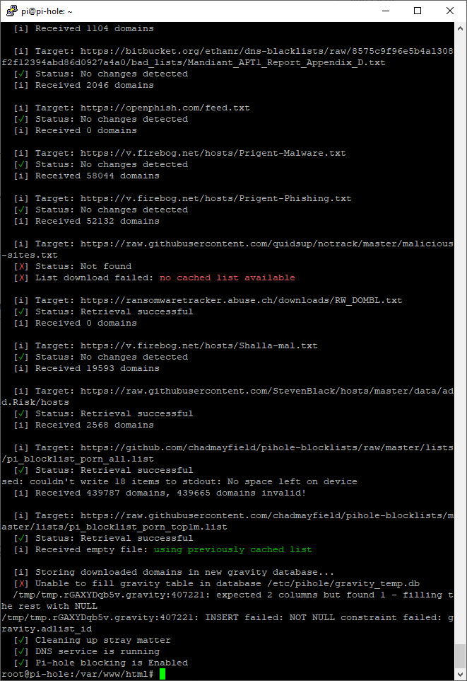

When running pihole -g I get "No space left on device" and later "Unable to fill gravity table in database /etc/pihole/gravity_temp.db".
I just updated from 5.0 to 5.1.1 and never had this issue before in years of using pi-hole.

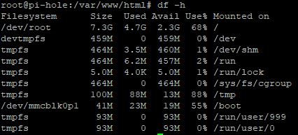

df -h returns this:
You will need to increase your tmp memory allocation.

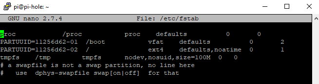

Hi jfb, in fstab tmp currently has 100M, how large an increase do you suggest?
Im running on an RPi 3b+.
I would double it to start.
Hi again,
It is fixed now, by commenting out the tmpfs line as per this: Make /tmp location configurable? - #9 by DL6ER
