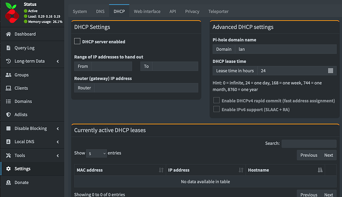

When starting Pihole in Docker with the following environment variables I expect that the UI would show DHCP Server Enabled as checked. Checking the UI shows the checkbox as not checked.
-e DHCP_ACTIVE="true" -e DHCP_START='10.0.0.100' -e DHCP_END='10.0.0.200' -e DHCP_ROUTER='10.0.0.1'
I expect that the UI element would be checked and the From: To: and Router: text fields would be populated with the values from the environment variables passed to docker.
The DHCP Server Enabled is not set (checked). The From: To: and Router: values are empty

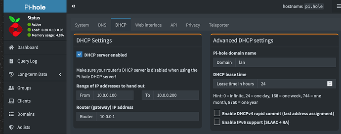

That solved it. Thanks. Reading up on the two links you sent. Appreciate your help!
