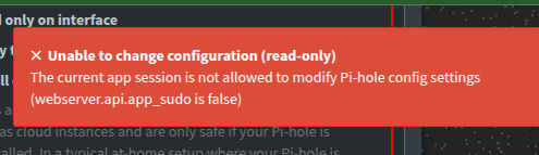

I have delete DEV version of Pihole few days back. Make clear new instalation and now I want to setup cloudflared.
When I want to change DNS to 127.0.0.1#5053
I get error message via added screenshot

FYI: I'm not running pihole in containter. It's running on Linux Mint statiion....

The screenshot is from desktop browser in LAN.

Hmmm... I missed this detail in the error message:
Apparently you used the wrong password to login to the web interface.
The "App Password" is meant for external applications and for security reasons it is restricted by default (it can't apply these changes).
You need to set and use the web interface password (internally called webserver.api.password).
You have 2 options to set/change this password:
  • CLI: use pihole setpassword
  • Web Interface: go to Settings > All settings page, Web interface and API tab, find webserver.api.password and change it (this won't work using the current password).

Thanks
It helps me
reset via CLI
