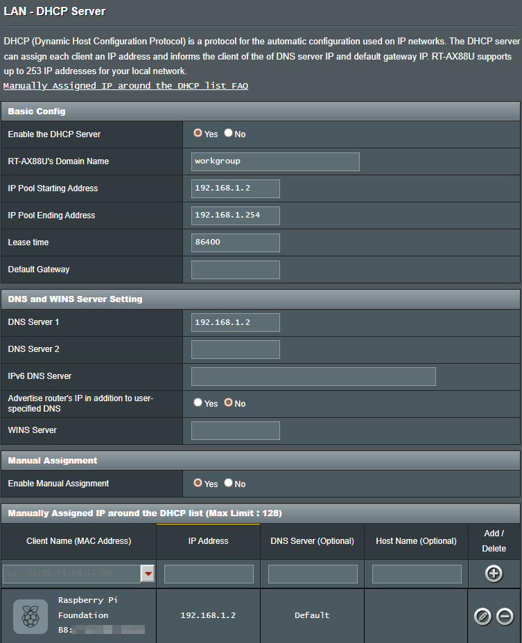

Google ads are not getting blocked.
https://tricorder.pi-hole.net/3j5EBDzq/
Router settings look good ... for the IPv4 part.
Except I would restrict the pool range from 192.168.1.50 to 192.168.1.250 instead to also allow to configure devices with a true static IP to be outside above DHCP scope (but within the same subnet).

Do you mean that by doing so, I can still manually assign static IPs to devices that are below .50?

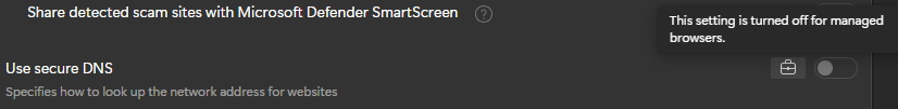

As a side note, I use the Edge browser, and I made sure I have this key/value pair in my Windows registry:
HKEY_LOCAL_MACHINE\SOFTWARE\Policies\Microsoft\Edge
BuiltInDnsClientEnabled [DWORD]
Value data: 0
With Firefox browser I don’t get the ads. (I just figured it out now…)
Yes.
I have all my network critical devices configured with manual static IP details on the devices themselves just in case of the DHCP server failing for some reason.
Output looks good.
If you localized it to the browser, try find below setting and make sure its disabled:
Will do. I’ll report back one I get to do it later today.
Are the results good for this? ‘sudo pihole-FTL dhcp-discover’
I can’t seem to use my own specified DNS address because it’s under a managed account (though it’s my account, not an organization account)
So aside from the registry change I’ve done, I don’t know how to execute setp 5: “Select the Enter custom provider drop-down menu and choose Cloudflare (1.1.1.1).”
You might have created that “managed browser” problem when you made that registry edit above. Try removing it or changing back to its original value then restart your browser; although since it’s a policy setting, it may require a reboot to take effect as it’s in the Local Machine hive.
You're not suppose to configure and enable DoH but make sure its disabled/turned off instead:
That setting allows the browser to bypass Pi-hole via DoH:

Just on a side note:
It would seem Edge considers itself as a managed browser (i.e. to be managed by policies rather than direct user interaction) if it finds at least one Edge related policy, which it seems is just what you've introduced by adding that registry key.
In order for Edge to allow you to control its Use secure DNS option, you'd probably need to remove all Edge policies.
But then your browser seems to show Use secure DNS as off already, and that's already what deHakkelaar had suggested to verify.
