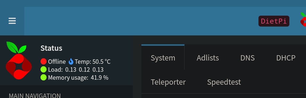

Yes, I can access the admin panel now. But shows offline red.
dietpi@DietPi:~$ systemctl status lighttpd

Strange is
active (exited)
code=exited, status=0/SUCCESS
Probably we checked too fast after the restart call, but the log looks good. Does it not show online state in admin panel? Else check again:
sudo systemctl status pihole-FTL
sudo tail -20 /var/log/pihole-FTL.log
