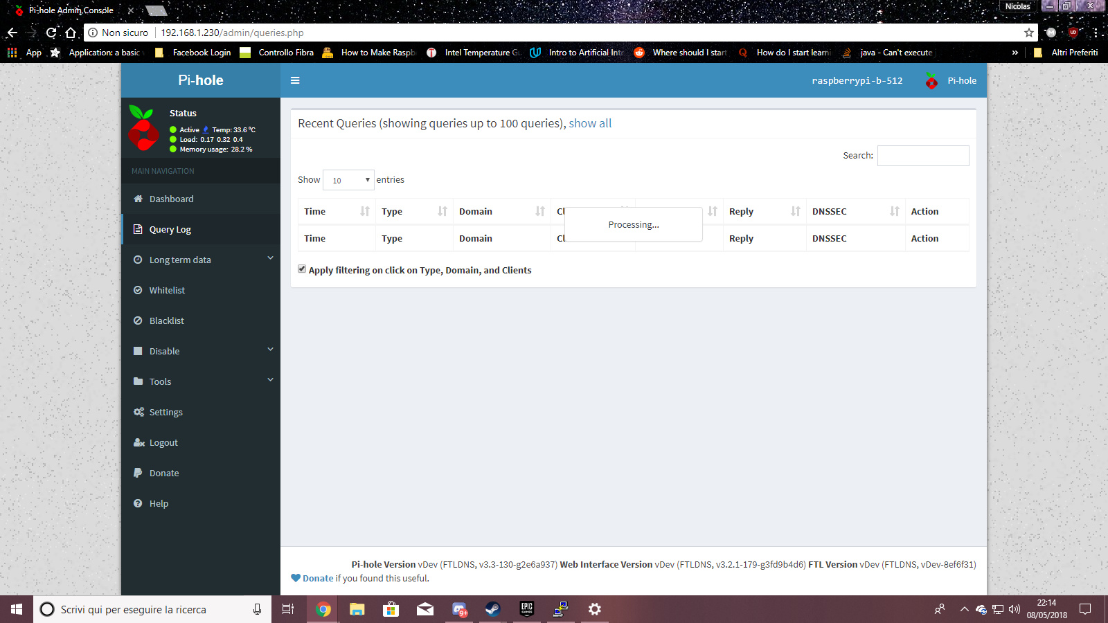

Unable to access Querylog
Expecting to see recent query logs
Page gets locked with the text "processing"

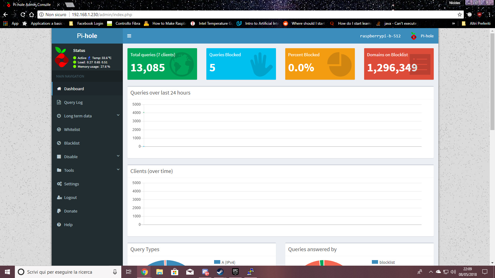

That's my main page. Weird that it says 0 queries. This happened after upgrading from 3.3 to beta. Before, it was working fine.
No, i don't see any errors in console

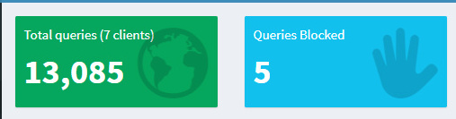

You actually have queries processed and blocked.
Check out your query log.
Graphs will take a little time to update. They are not rendered in real time but hourly.
Check in a few hours :slight_smile:

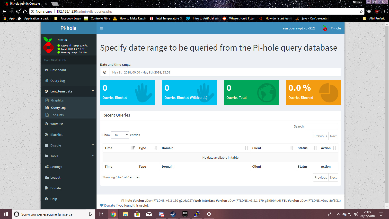

That's the problem that i'm seeing. Is it normal ? Its locked here
Edit:

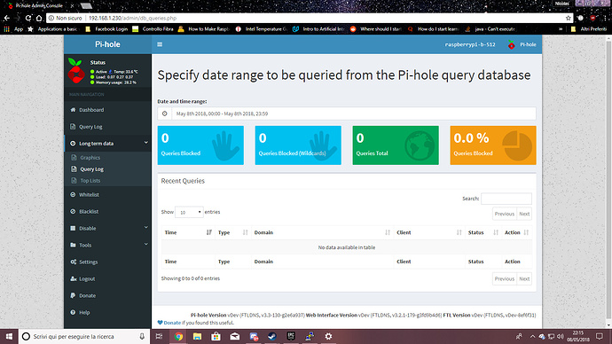

This doesnt work too even if i have 30 queries blocked
