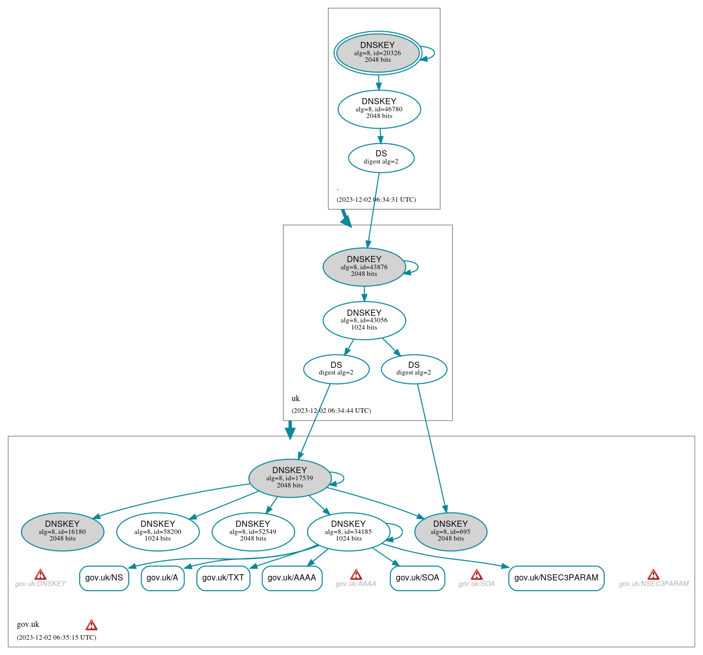

I worked through this problem with technical support at Janet, gov.uk's provider. Their initial reply was:
Please be advised, and rest assured, that DNSSec for .gov.uk is not failing and there are no issues with any of the nameservers that serve the zone. The perceived issue that you have reported is a direct result of DDoS mitigation attempts undertaken by the security systems that protect the Verizon nameserver that you reference. The automated tool that you reference generates a number of repeated and rapidly successive probes which are being mitigated before reaching the nameserver, hence the appearance of a failure of the nameserver itself to respond to some queries. If you examine a combination of results from the tool, you can see that they’re all related to query timeouts and that the specific queries that are timing out vary over successive attempts. This, ultimately, has no impact on genuine, operational DNS lookups aimed towards the nameserver.
Putting my router into modem mode and using an old router that I flashed with openwrt proved the problem is with Virgin Media's router.
Interesting, yes I do use VM and their Hub 5. I’ll give this a go. Thanks!
I still don't think this is accurate, third-party DNSSEC debugging tools show several issues, too, see e.g. the one @jfb linked above:
  • gov.uk zone: The server(s) were not responsive to queries over TCP. (192.76.144.14, 2001:600:1c0:e001::35:6)
  • gov.uk/AAAA: No response was received from the server over UDP (tried 12 times). (192.76.144.14, 2001:600:1c0:e001::35:6, UDP_-NOEDNS)
  • gov.uk/DNSKEY: No response was received from the server over UDP (tried 12 times). (192.76.144.14, 2001:600:1c0:e001::35:6, UDP_-EDNS0_4096_D_KN, UDP-NOEDNS)
  • gov.uk/DNSKEY: No response was received from the server over UDP (tried 4 times). (192.76.144.14, 2001:600:1c0:e001::35:6, UDP_-_EDNS0_512_D_KN)
  • gov.uk/NSEC3PARAM: No response was received from the server over UDP (tried 12 times). (192.76.144.14, UDP_-NOEDNS)
  • gov.uk/SOA: No response was received from the server over TCP (tried 3 times). (192.76.144.14, 2001:600:1c0:e001::35:6, TCP_-_EDNS0_4096_D_N)
  • gov.uk/SOA: No response was received from the server over UDP (tried 12 times). (192.76.144.14, 2001:600:1c0:e001::35:6, UDP_-NOEDNS)
Their support explain that because of the nature of DNSViz's multiple queries, their antiDDOS protection kicks in.
They suggested:
I do think that you’re on the right track though, in the sense that there’s a commonality in terms of the size / type of query responses that are failing.
One thing I’ve noticed is that when, say, querying Google’s DNS on 8.8.8.8 for “gov.uk dnskey”, the response is sent in a single UDP packet - whereas the responses from the authoritative servers are truncated using TCP. I’m wondering if the TCP response is causing an issue somewhere, perhaps. Some queries you could try to help determine this:
If you have a firewall that fronts your Internet connection, it would be worth running a packet capture on the WAN interface whilst running both working and non-working queries. You can then analyse the pcap file in Wireshark, or similar, and verify exactly what response you’re seeing from the nameservers. Some routers may also have this level of functionality if you don’t have a hardware firewall in place. If the responses look good from the WAN interface, then repeat the capture on the LAN facing interface and finally on the interface of the LAN device running the query to help pinpoint the cause. Of course, if you’re not seeing a response on the WAN interface at all, then further investigations by your ISP may be required.
At this point I decided I was working above my pay grade. If I put Virgin's Hub 5 router into modem mode and use another router (I used OpenWrt) then I end up on a different IP address range and DNSSEC works. It is either the router or the address range. I tried cloning the router's MAC address to get the same IP address but that didn't give me an IP address.
My guess would have gone into the direction of MTU but as long as there is a viable workaround :wink:
And calling blocking of 12 of current can be called "antiDDos" or is just too radical is on them...

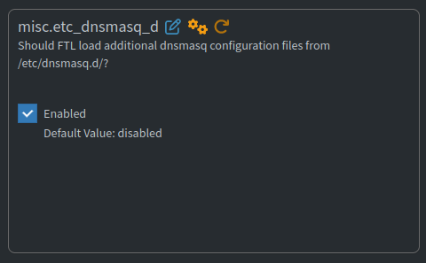

I have added that into my config file, but it still does not seem to be working.
root@ubuntu:/etc/dnsmasq.d# cat 99-my-settings.conf
server=/*.gov.uk/1.0.0.1
Note: I do not have DNSSEC enabled.
Did you enable this setting?
I did not. I now have, but still not working. The query log now shows it as:

;; received packet from 192.168.88.254#53
;; ->>HEADER<<- opcode: QUERY, status: NOERROR, id:  50519
;; flags: qr rd ra; QUESTION: 1, ANSWER: 8, AUTHORITY: 0, ADDITIONAL: 1
; EDNS: version: 0, flags: do; udp: 1232
;gov.uk.                                IN      DNSKEY
;gov.uk.                        86157   IN      DNSKEY  257 3 8 (
;                                               AwEAAeIcG2L49RCQsIa2JycNpAQd
;                                               2x/lEgwRUc2RXa8eLnfzj0EkpnUX
;                                               rtTrYndUdFqoo1LlpVQfUIWSBMpc
;                                               m7LOhD9EYvWSdXBB+k00jo2vE7yc
;                                               nIcdmrPE768AkLlDZj87iuQsFxWQ
;                                               Ew9pw7ZEbC7bwaqarp6FRJed70Bc
;                                               ygotjsKPkXcw2rr/E8hW+DacKi46
;                                               P+3a/HCTltvIRV/T4RUDyvOqnZ9o
;                                               aRXBjaQ74EtFJF5aDKj3uFkN20st
;                                               8CarE14UfVStP9RHTZKN1WN9PiHb
;                                               gZrV+m2d9TrGrCnDkqJ78rQFeUL3
;                                               NNLtF5uwoKXS1EA3djoIyCCg7dSb
;                                               ldP8mkPFNik=
;                                               ) ; KSK; alg = RSASHA256 ; key id = 17539
;                                               AwEAAc4btyvhzTFwusTMj7fuVvXJ
;                                               VCeCFu70xH93voWNDf9rXwbamYO5
;                                               c64EmT+RAVqdKV5g44sHSlGjbpNs
;                                               PsaVO/Gqzbxpbyk2Via5dZZxl7r1
;                                               oC8qo2L3G4U1whuDTsfRhWjHZOh9
;                                               UoZkHvK2vL1I7EBkE+s3297n1pQX
;                                               Wt2Ijlh3iOIbGYXLnAA+0OHdTROz
;                                               cfQ57VYJ5nKoBOxkJFN6bqSadnJN
;                                               CjzHrPVHSDL1xwwPubxKG2xCpr99
;                                               9lG+y+zLdEOA8/mRgS5KS2PF9BuV
;                                               W17NHp8+sHSQ3A1X5YszNsF77+h2
;                                               p7p9xQ9KnQ+9P8wMDWXo9C4NgTdO
;                                               j/8kJ/F7xAs=
;                                               ) ; KSK; alg = RSASHA256 ; key id = 695
;gov.uk.                        86157   IN      DNSKEY  256 3 8 (
;                                               AwEAAcJukFZUAWea7L1qKXRWGf8g
;                                               JnQIReGMKjIK/VU5DEGnoMhJ8tDk
;                                               3LqhXhAzafLNhW9ybXfEyY0L4FDQ
;                                               EOdhr7syLhnEkmJWDLld2rYlyhVj
;                                               sQthunsqf9KbBtTFUaDZaB8QAH3u
;                                               Zb/5/kWDSk/22RfkHivop54it40Z
;                                               nFRmZvP3
;                                               ) ; ZSK; alg = RSASHA256 ; key id = 34185
;                                               AwEAAcrWS7rvsJMswiDC6ty9ryAz
;                                               A1BMc12vFm1rL23Uud8EeVbyKZBk
;                                               k38z0fODPupIyjyui3xwU6stMeXq
;                                               srR1N1NpYMdmvsw5K4C5j1HiyaAV
;                                               UfH+qasHSwkngy+gAHdU6esTr0Ef
;                                               Y2p0tvSGc3ZFdbv15W+S1DPzK2Ml
;                                               zehbNAotheIyjULUpTQXSnQRwChI
;                                               A5xw0LVRA5v52yf8qCvdMIJEQbDi
;                                               gX1r/moR2RZs2v5aCS9G5OlXDlvM
;                                               NXf7cd1+8O7X6PorpsVak5atMNr/
;                                               wM5dgaOhyiFcHbIBxsT8zVJF3/Er
;                                               WWohOI+j8Pf2nOizPb4Koo7ROAYg
;                                               XjJ+CC9a+Qc=
;                                               ) ; ZSK; alg = RSASHA256 ; key id = 52549
;                                               AwEAAeA4pzKgU1t4lKhkKDNlrnCU
;                                               HySm6CJMgTnUUXElCht6L+C344y7
;                                               DhClQWsOtgVkWPUO4XzhjvMUHCxH
;                                               owqH5C9qkiyIAmvTdkI+pGEL0VHB
;                                               wCLvlEWdV+NG6CvUJAWNijwTPHPA
;                                               NqcttIGlUz33NMtUXFvfbm1UZTRL
;                                               w0rbdQT5
;                                               ) ; ZSK; alg = RSASHA256 ; key id = 58200
;                                               AwEAAZhEwwuAdnpNbyhIGJwh/D28
;                                               XjVp9NacL3h8iMR9wCgwdZWf41p8
;                                               1qrJqrX1sKoJzPPq1G3ecIQignJz
;                                               CPhyEwXb36MSmhabVAFvUY6p4KfQ
;                                               IxVioffJ9lt0OJDbiWjK8mkDgi25
;                                               +I57rk6RuBK/BARLSDenpU0qk7rC
;                                               xTTiQBBoncav/3Db6xoQ4ciqaEsv
;                                               hqZqhz3nau0oxKfaVc7PQbB0RLRd
;                                               kBWkZv86nJsKVSmi5ACT3f3rgZ6P
;                                               B8hAhY3slg5xWRK7BxSAwy0SbHIx
;                                               mbcvKQtX57kOlHQFUgV+hJXn/4Y4
;                                               HmtXdBo5tVKeIOVLZ3Kd/MCgAEaH
;                                               a1GbPuYjFOs=
;                                               ) ; KSK; alg = RSASHA256 ; key id = 16180
;gov.uk.                        86157   IN      RRSIG   DNSKEY 8 2 86400 (
;                                               20231231140755 20231201140755 17539 gov.uk.
;                                               U26ZBGjxssj8MfsVmAZfakT+c0mg
;                                               Y3fcKUJzU3oAd76YcVWxkFDvatOF
;                                               SsVH1XLEAKW1DPc+7oxkthmKgOyE
;                                               J6O90v+bG2xBHRl1jV2nQU3LtsNv
;                                               SPqYryoqX2NyZnB4GSO0gfUd8GVg
;                                               1nliJFxwFvX+WJchSZTbuuQvUIME
;                                               m+9ntKIyfCHdcOWK92sUc3X+H7sd
;                                               HKlEOoEFEUe4qijutJOpdZyKAxpf
;                                               io1WrrRU3NwMPoFZnbBK4uD/+Ltx
;                                               1Nity/hXbszagZNgKTYM5nogT9vp
;                                               jrRfAsypZXfsrhXCAn7aCzk4PJ53
;                                               pbhU3IawIm3dPeUGzDbL8rVuXCJR
;                                               Jp0HCA== )
;                                               20231231140755 20231201140755 34185 gov.uk.
;                                               NxPK0EgqgI1NzEiufIhafHMAelxM
;                                               nPAjMXXcK25e0oHkqOqAGT5/if57
;                                               KAT8aSOxeTDW03jEYIshmErXG+96
;                                               j5w0jUuKVtaqFpxkB5AViL6VfLcs
;                                               9aBiR9uXhwkNVey9xqRQU8tr4q5D
;                                               9n7l8BW8ihgbwNod3aq/VIOesn6B
;                                               7rU= )
;; fetch: gov.uk/DS
;; ->>HEADER<<- opcode: QUERY, status: NOERROR, id:  32841
;; flags: qr rd ra; QUESTION: 1, ANSWER: 3, AUTHORITY: 0, ADDITIONAL: 1
;gov.uk.                                IN      DS
;gov.uk.                        34      IN      DS      17539 8 2 (
;                                               2F0A0A65DB9E930F5B2C0425F67D
;                                               F66416C076124652A281D9A8FFA7
;                                               73828F57 )
;gov.uk.                        34      IN      DS      695 8 2 (
;                                               7277592DBD8993BDE70704DBABD3
;                                               0AFDBB85057E658EF1428F18F5D9
;                                               A534BCE0 )
;gov.uk.                        34      IN      RRSIG   DS 8 2 300 (
;                                               20231216133302 20231202123855 43056 uk.
;                                               2qKljACQacgmVSxe7Vu1O+ORyipZ
;                                               fXan1gZQdSLWZDLrCn6LObRq1aU9
;                                               u39eBQcpFasG4t1Yu88bk1ME03Ek
;                                               s2l+08LY6RPKUzmZRG7xR3KLgyWi
;                                               Oh4m5OIUXHxEYzMNCzC3SqAGB8B1
;                                               hp2v9UNBvmIxgeI8BuwFVkcU7Hg8
;                                               bSQ= )
;; fetch: uk/DNSKEY
;; ->>HEADER<<- opcode: QUERY, status: NOERROR, id:  32388
;uk.                            IN      DNSKEY
;uk.                    3357    IN      DNSKEY  256 3 8 (
;                                               AwEAAeGOYY7fiJwowB47qBZS9G67
;                                               Bas0rIb23LgGVw1du1K3Is6H2Lxf
;                                               WvtEYyrZ5BE5ddSwLsgz7F8v/kIB
;                                               XFhjltAkaU8o+AYSIqDDPlz4+0L1
;                                               e/ofv42uJ6pcygi74WAWhJOE/Qoo
;                                               RUeO8zwTIru7EgmtjxFXZunQJJmC
;                                               ygY1l5OZ
;                                               ) ; ZSK; alg = RSASHA256 ; key id = 43056
;uk.                    3357    IN      DNSKEY  257 3 8 (
;                                               AwEAAbOOWSsuXCZ8x/DBsz2tC/58
;                                               YYi/qul9Mk8sJm5HyNYgQ0oyg6KI
;                                               xaPvmqcHfyiwma9p+f8SjFZa/51z
;                                               YQQzWK1flMFyNMl2YMHS/E+7NNa+
;                                               f1DND23FyBu2VGrXf50c72KVG1s1
;                                               qnlEusPbkBzh2zdYRJtiVan+P4Or
;                                               PmwRfxwfsl7blNWJQkHg2Gy+WeAm
;                                               AY7PFFlHeDqfYQCJ5bqXJzcvTbh1
;                                               dPzWuBPeynjXFXCbC5msJQbLcm1K
;                                               Jx2cMNdJJxW9raXj75MJFtotwAGY
;                                               i7UL285qqia1e6MWfbZKbSmBxkrl
;                                               iGJNSfopBeesJ6LjWHaj+5W/rJdj
;                                               yhjv3AWNMHE=
;                                               ) ; KSK; alg = RSASHA256 ; key id = 43876
;uk.                    3357    IN      RRSIG   DNSKEY 8 1 3600 (
;                                               20231216162225 20231202154710 43876 uk.
;                                               Xsce4RwSUqzw5E6oB/WagCh212fb
;                                               x9YElghCmFtCnCi8gHkHm9SYb5oe
;                                               nH4mvjjSCG0XHgFM90VY33pSWlAG
;                                               HqFuC139EGZ6yg/lPJrzRnZT0dRM
;                                               6ybBXLzxz2BBsmc09o9lAM4s7wtm
;                                               pIy3J1t74vYTgNfKaJ3lr8zzCKsz
;                                               0MCZjIVM3MhctzopDrJSTaEszGEZ
;                                               jpKTTFXXAV5f6VAjf7wBfctrI5hm
;                                               6+bryDp4PNJLKrUDg3BFz8jxpn4+
;                                               yLaSFwbSo4u178pxAXYcvbIWLz/j
;                                               sR+WrX0HCmYmu+3QQpDOlWXS1mKk
;                                               sGFA+L31be3R242tE2ExqmigDYjd
;                                               1mBVcA== )
;; fetch: uk/DS
;; ->>HEADER<<- opcode: QUERY, status: NOERROR, id:   2977
;; flags: qr rd ra; QUESTION: 1, ANSWER: 2, AUTHORITY: 0, ADDITIONAL: 1
;uk.                            IN      DS
;uk.                    42115   IN      DS      43876 8 2 (
;                                               A107ED2AC1BD14D924173BC7E827
;                                               A1153582072394F9272BA37E2353
;                                               BC659603 )
