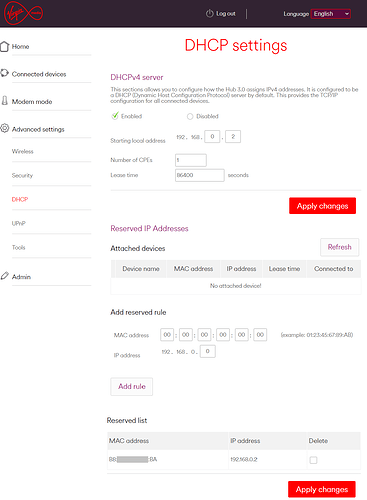

  • access Hub 3 and navigate to DCHP Tab
  • give your raspberry pi a static IP. and set the "number of CPEs" field to 1(one).
  • in the local starting address put the IP of your RPi.
    for example:

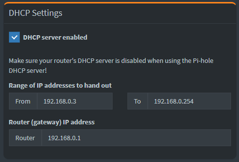

now set your Pi-hole up like this

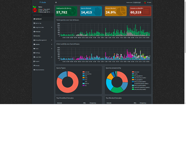

mines been up for a little over 24hrs. this is the result
