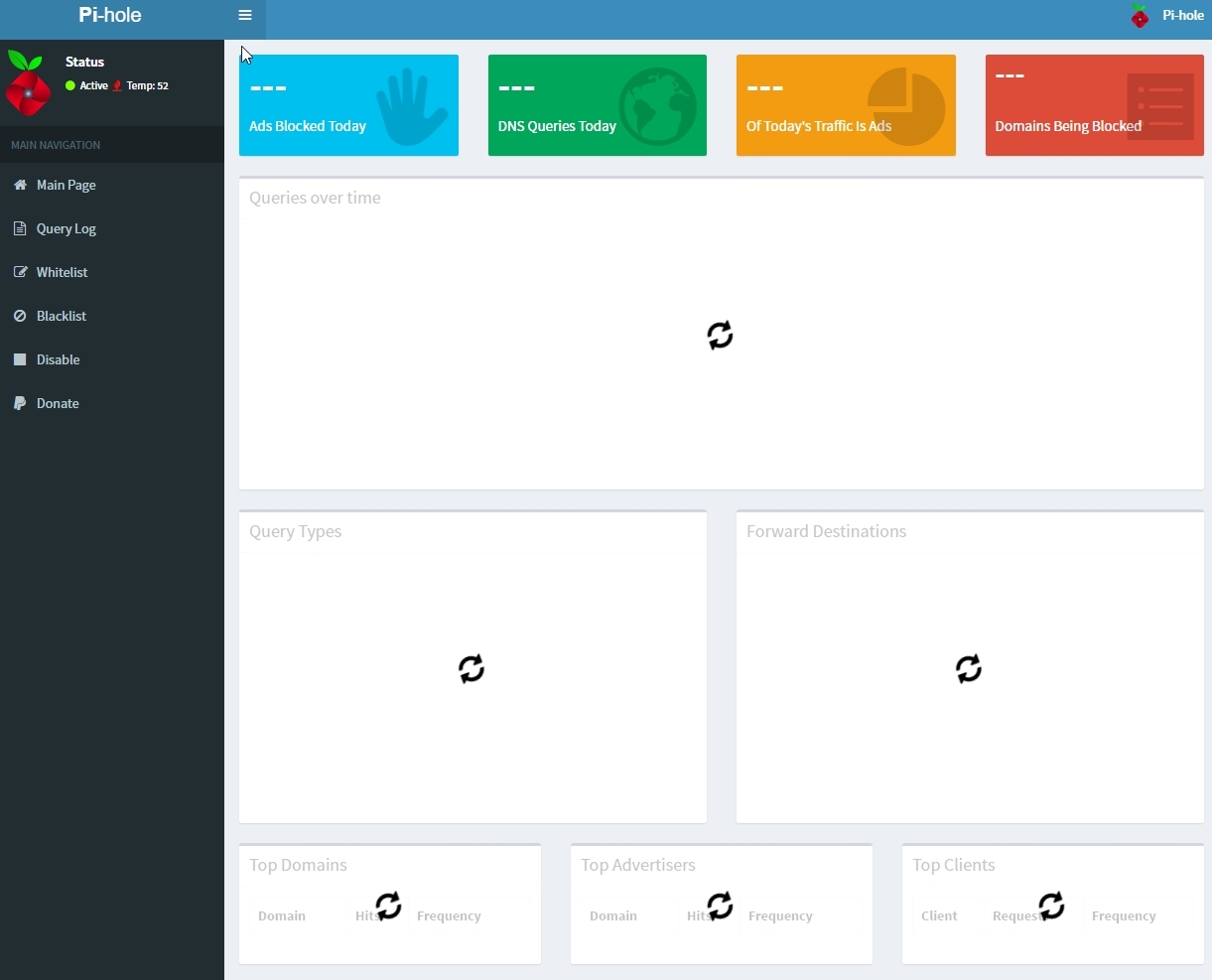

UI will not load values and default DNS server no longer pi-hole
Hi All,
Tried to access the admin UI just now and it was unresponsive. Updated pi-hole and raspbian, rebooted, did pihole -g, rebooted again and still the issue persists, UI appears but none of the counters load. Did an nslookup and instead of the usual "pihole" the default server is now "0000mps.webpreview.dsl.net" - no idea what that is.

This may be related to a recent reversion in code we made. We used to stack the deck with the /etc/pihole/gravity.list file and place a token pi.hole entry so that if you ever pinged or tried to nslookup/dig your pi-hole address, you'd get back pi-hole. We felt that the adlist wasn't the best place for our name, so we took it out. If you head /etc/pihole/gravity.list the first entry, and the one that dnsmasq returns as the DNS name of your Pi-hole, will most likely be that foreign address. This is a good thing in that it indicates operational status.
Next would be a pihole -d and then pass us the token with your debug ID so we can check our server for the debug log if you agree to upload your logfile.

You are correct that the site indicated is the first entry in gravity.list, great to know. As I didn't know what was happening last night, I shut off my router but let everything else remain on. This morning I powered the router back on the UI is responsive and working as expected. This is unexpected because I had rebooted the router several times last night but the UI remained unresponsive.
I am unclear if the log is cumulative. If it is, I ran one last night and this morning. If not, you will only see this morning when it is working as expected again. In looking at it, I see a lot of these lines which seem interesting:
2016-11-02 21:20:30: (mod_fastcgi.c.2702) FastCGI-stderr: PHP Fatal error: Maximum execution time of 30 seconds exceeded in /var/www/html/admin/data.php on line 197

Thank you, the logs are individual and do time out after 24 hours for user privacy. I took a look at the latest, and the errors are indicative of a large Pi-hole access log. That would explain why you were able to access the UI after an overnight shutdown. There is a cron process that will clear the Pi-hole access logs overnight so that they are clear every morning. We're in the process of upgrading the script to handle larger log files, and this issue should be fully resolved when we are able to release that upgrade. You may notice that the UI does become slower later in the day or evening as the logs fill up, let us know if that seems to be the condition you are seeing.

Thanks for the explanation, makes perfect sense. Has slowed down a bit tonight but not like last night where it was just unresponsive. Uploaded a new log for your review.

It indeed does look like you're affected by the log size situation. The timeout values being exceeded in the PHP logs usually happens when the files just grow to be too bug for the parser to handle. We're working on a resolution for that.
