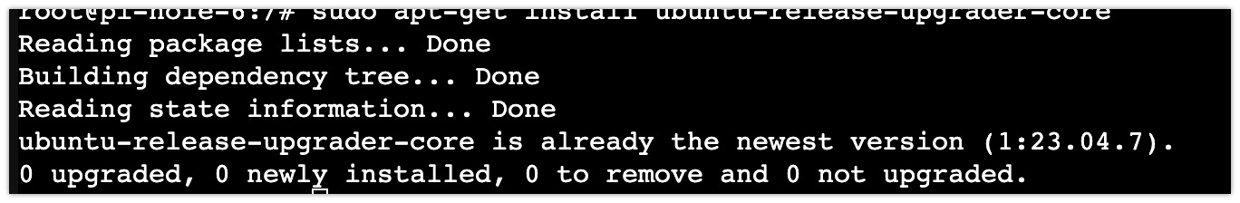

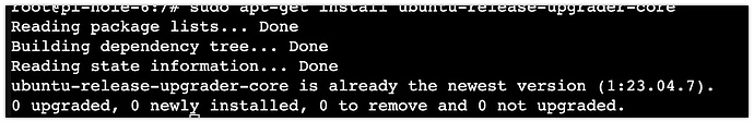

Thank you for the info. I do not understand how the upgrade should work. I am pretty sure I do not have a desktop so I have to go with the "servers".

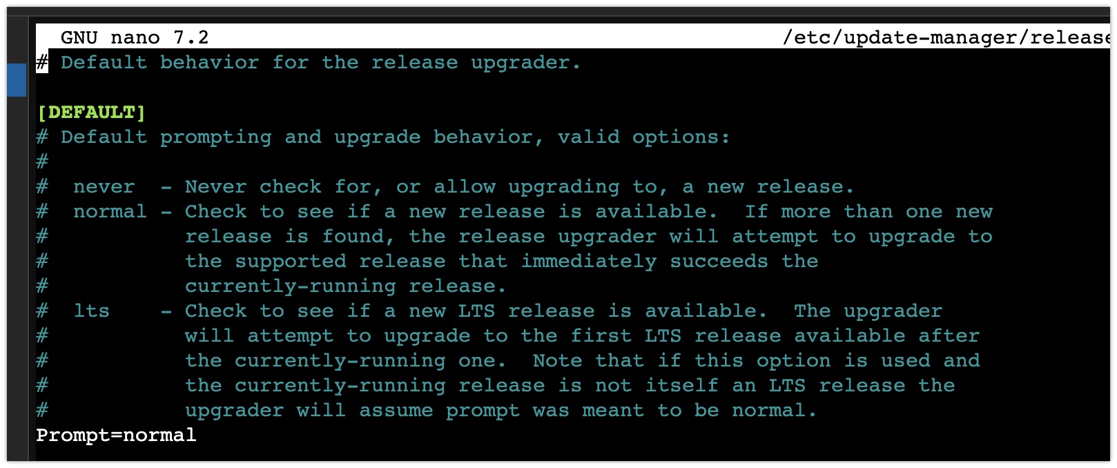

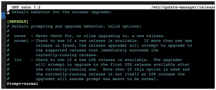

It was set to "normal".
So what does this mean?

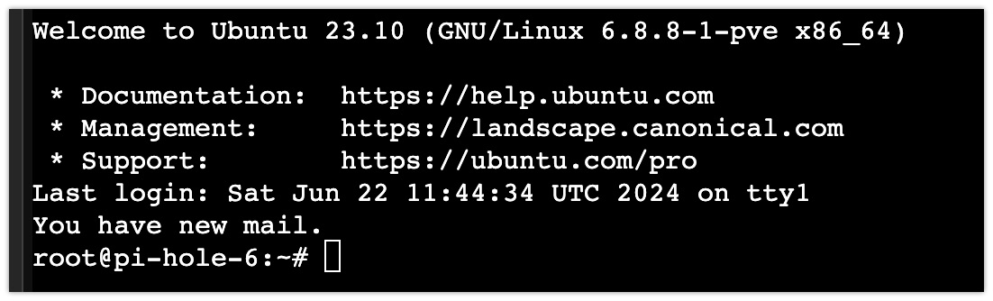

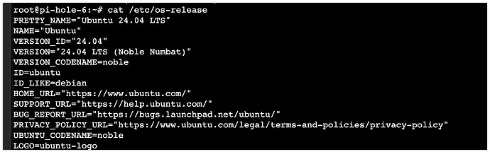

Looks like "sudo do-release-upgrade" is doing the job. At least it is doing something... Let's see what happens!
Perfection is what happens....

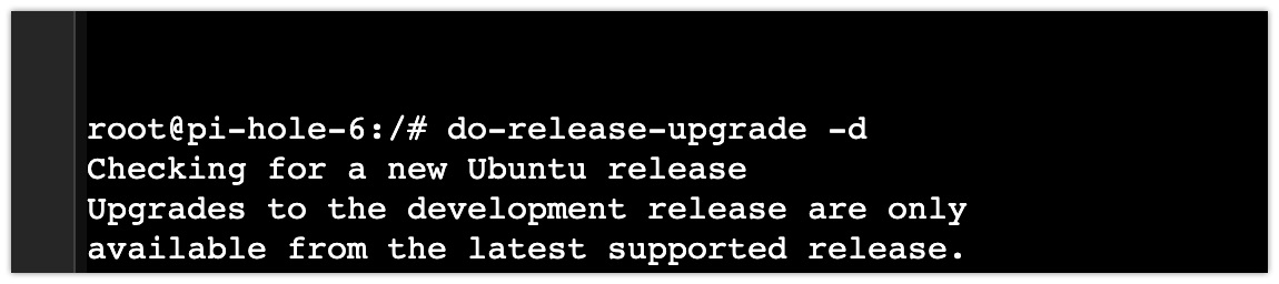

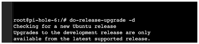

Thanks for the help guys. What difference would the "-d" have made? I left that out....
I'm not sure. I'm not an Ubuntu user. You should be able to run man do-release-upgrade or do-release-upgrade --help to get information on the options.

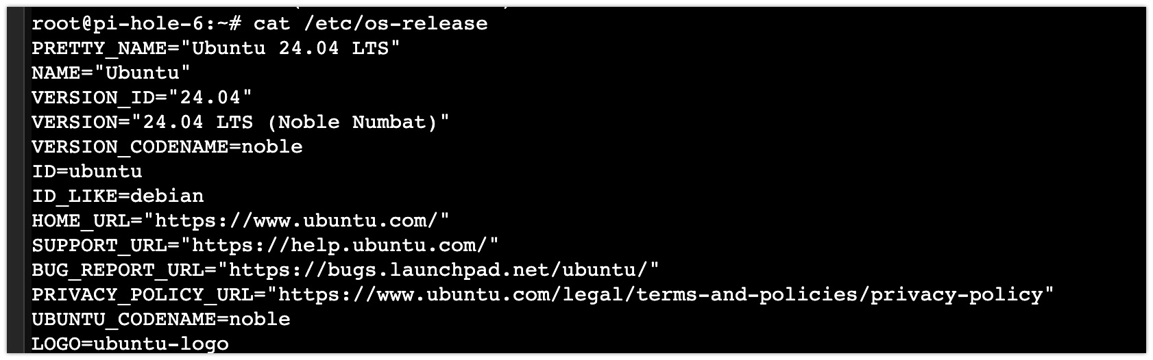

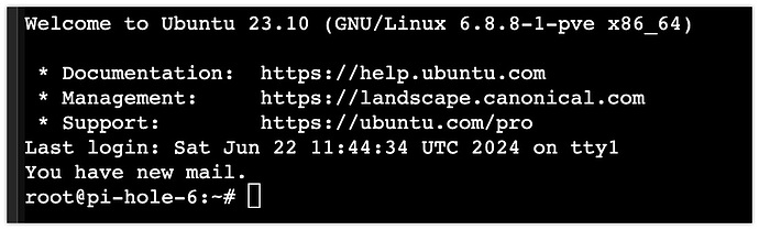

If I understand it correctly, I should be good for a while... :relieved:
You should upgrade your Ubuntu Distribution to the latest version. Right now, the latest version is Ubuntu 24.04 LTS Noble Numbat. I think you aren't getting the updates because you have a version that reached its end-of-support period. I hope this solves your problem.
Thank you, but as you can see in my screen shot, that is where I currently am. Updates are working again. :+1:t3:
