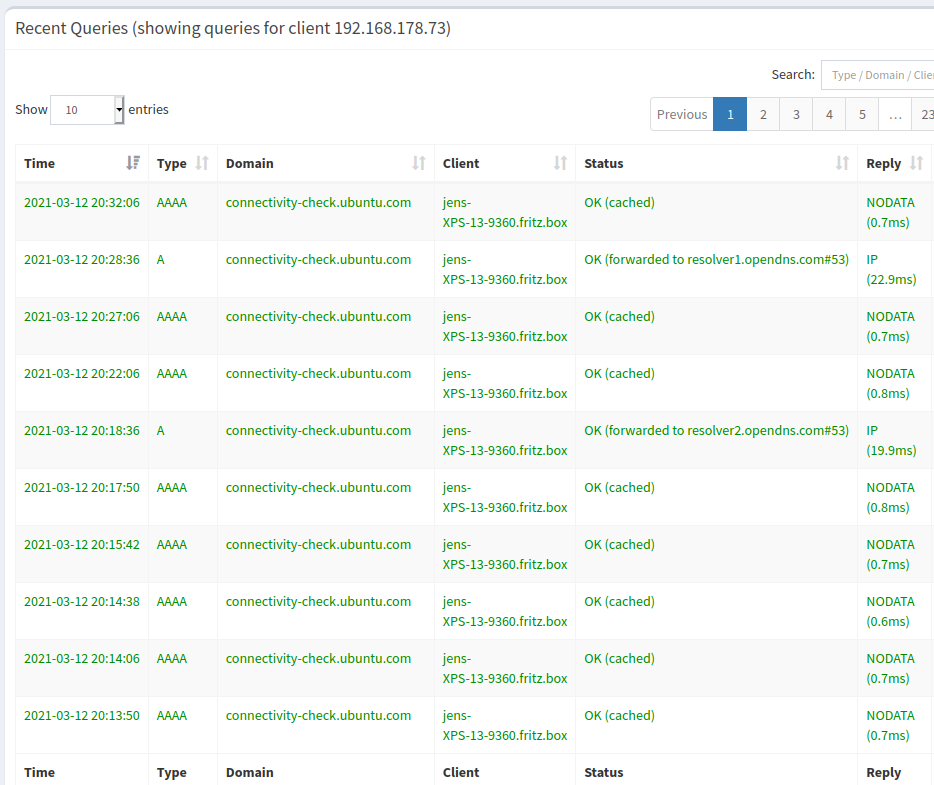

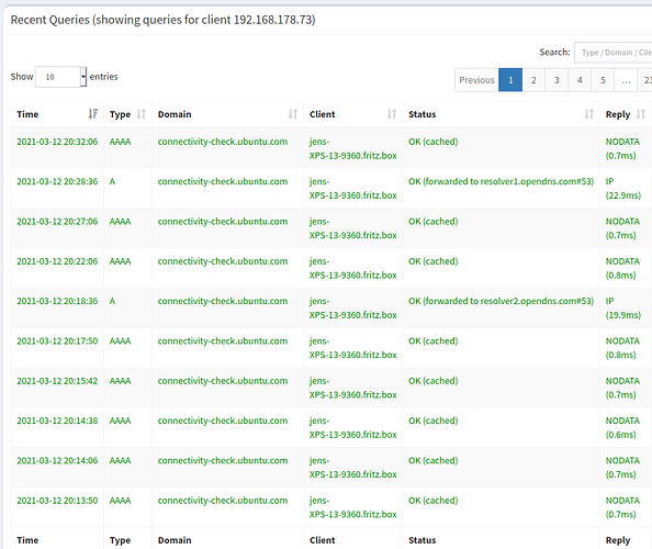

My pihole runs on a raspy W ZERO. Everything works fine in my network except for one device: I have Ubuntu 20.04 running on my laptop (Dell XP11). All connections are cached or forwarded. There is just one Domain tracked: connectivity-check.ubuntu.com
I thought its a cache problem so I flushed all the caches according to https://discourse.pi-hole.net/t/how-do-i-flush-my-pi-hole-cache/3020. However it did not help....
Here a screenshot of the queries:
Any ideas?

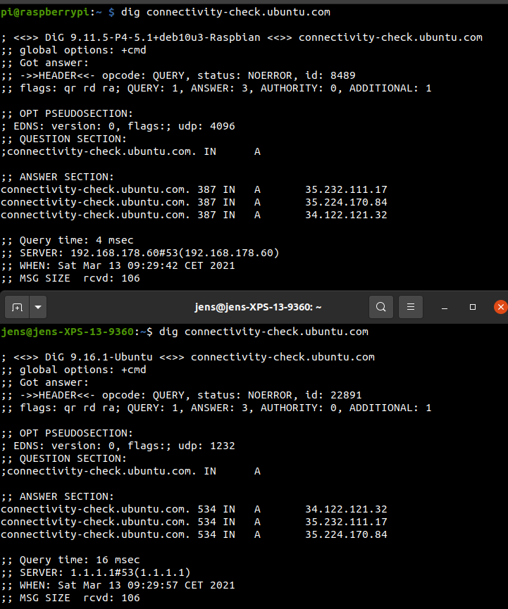

Please run
dig connectivity-check.ubuntu.com
once on your Dell PC and once on the Pi-hole and show us the output. How does the Query Log look like after you did that?
Thanks for the quick reply. Here the output:
The Query Log has not changed....
This shows that the XPS-13 client uses 1.1.1.1 as upstream resolver. How did you configure it to (only!) use your Pi-hole for DNS?
Your XPS-13-9360 is using 1.1.1.1 for DNS, definitely not Pi-hole.
You'd have to fix that.

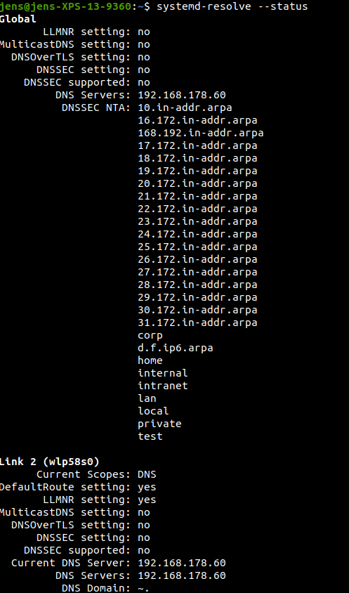

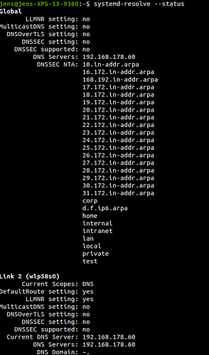

Thanks for the reply. I configured it using the GUI. Now additionally I added in /etc/systemd/resolved.conf the DNS server.... According to systemd-resolve --status it looks fine:
However if I dig connectivity-check.ubuntu.com then it still the old DNS Server:
Where/how can I change the DNS adress?

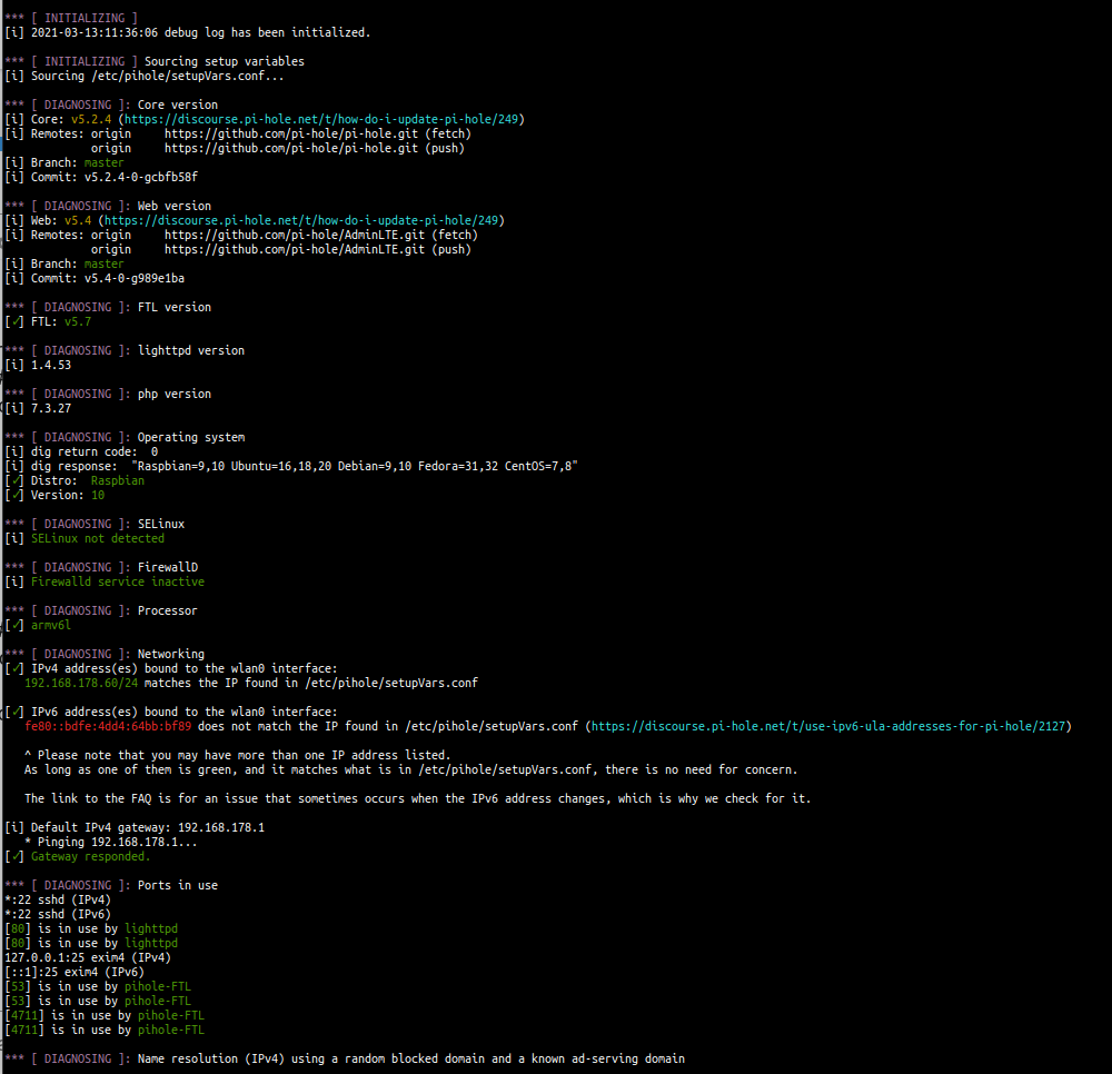

pihole -d produces:
(sorry for the resolution, as a new user I can not paste the terminal output because of some link restriction)
Here it gets stuck. The Web interface does not produce any output.
On my router I disabled IPv6.
We don't want the printout of the log, we want the token that is generated when you upload the log. That allows a few people on the Pi-hole team to access your log in full, and protects your privacy.
Git it... Thanks: https://tricorder.pi-hole.net/a1qyqnbcm2
Unrelated to this problem, but noted in your debug log. If you take a look at the output of pihole -g regarding this URL, you will find it loads no domains. This URL leads to a list of other URLs. What you should do is copy all the listed URL's to your clipboard, and then paste that lot into the Group Management > Adlists page.
https://v.firebog.net/hosts/lists.php?type=tick
Your debug log shows that Pi-hole is working properly. It also shows that your DHCP server is providing the IP of Pi-hole for DNS. The problem appears to lie in the client that is using 1.1.1.1 for DNS, not in Pi-hole.

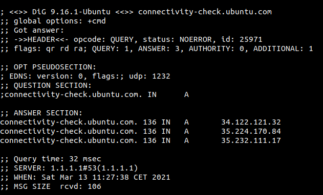

Thanks for the that. Just one last question. As you can see in my post above the client according to systemd-resolve --status uses the right DNS. However, if I dig connectivity-check. ubuntu. com then it still the old DNS Server. Where can I finally set it up correctly?
Thanks
Thank you very much. I have one last question. How can I change the DNS server on my guest device. I have shown above that via systemd-resolve --status it seems that I have the right DNS Server however via "dig" it shows the 1.1.1.1.
