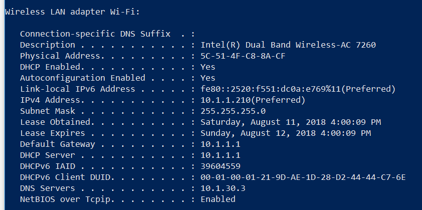

Question 1: I had been setting the DNS entries manually to avoid borking up the network (wife and kids you know), but I went ahead and assigned the pi-hole address into the main net (10.1.1.0/24) DHCP server. Then connected a laptop to do the testing. Pasted below is a snippet with output of ipconfig /all which shows it has the right address and only that address:

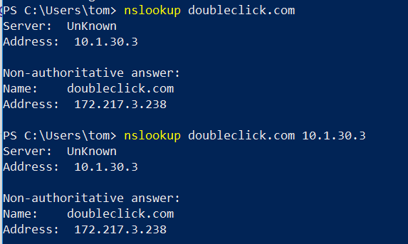

Question 2: Pasted below is the output of the commands you specified:

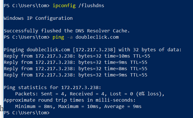

Question 3: Struggled a bit to figure out how to capture this correctly, but settled on ping -a. If I need to something else, let me know:

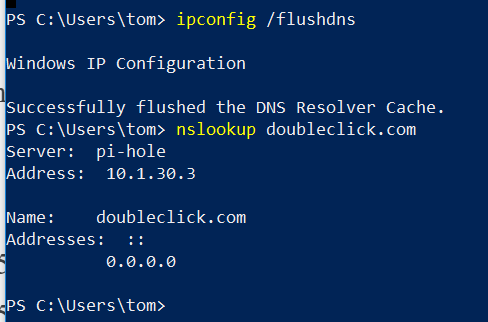

For validation, on the same machine, I switched over the the 10.1.30.0/24 net and did the same thing, but had a different response:
Finally, the computer that I'm using is not showing up in the query log, at all. I do have a few entries for a phone, but they are all passed. Not nearly the traffic I would think it should be seeing, so this is likely the problem. For some reason, I can get DNS resolution, but without the pihole seeing it enough to log. When I am connected to the same network that the pihole is attached to I see query's along with blocks in the log. I can't figure out where it could be getting DNS from when on the main LAN. You can see there is only one listing for the DNS server in ipconfig. I also checked the EdgeOS config tree to ensure dnsmasq is NOT enabled on the router.

It looks like on the main VLAN the DNS traffic is getting redirected to a different server instead of going through Pi-hole. If it had gotten any response from Pi-hole, it would have been logged.
Check if you can resolve pi.hole. If you can, then it is hitting Pi-hole correctly. Otherwise, the request is not actually going to Pi-hole.
To check if a blocked domain is blocked by Pi-hole, you can also use the same nslookup commands. You can see in the last screenshot that Pi-hole returned the null domains in response to a blocked domain.
