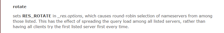

That's actually not true. You can not depend on any order for DNS servers. If multiple DNS servers are configured then you can pretty much guaranty that all will be used. If you don't declare "strict order" then each OS will use it's pre-designed method of round robin or weighted round robin choice.
Yes it depends on the configuration of the client but the default behavior for Linux clients are strict order unless you specify. In my home lab I have done multiple tests of this and they always goes in the order as I listed them on the resolve.conf
As for Windows this is a little more complex but if you define them per adapter bind the bind priority determines the resolver that will be used and it's "usually" sequential to the network config.
If you want real control than a VIP is needed along with a load balancing model that enforces strict order irrespective of client. At work we use the Anycast model for geographic location each location then has a VIP that has 4 dns servers behind that IP. We also use DNS capturing to cover rogue DNS lookup's that try to bypass our internal servers. Seems to work well for 80k worker endpoints.
