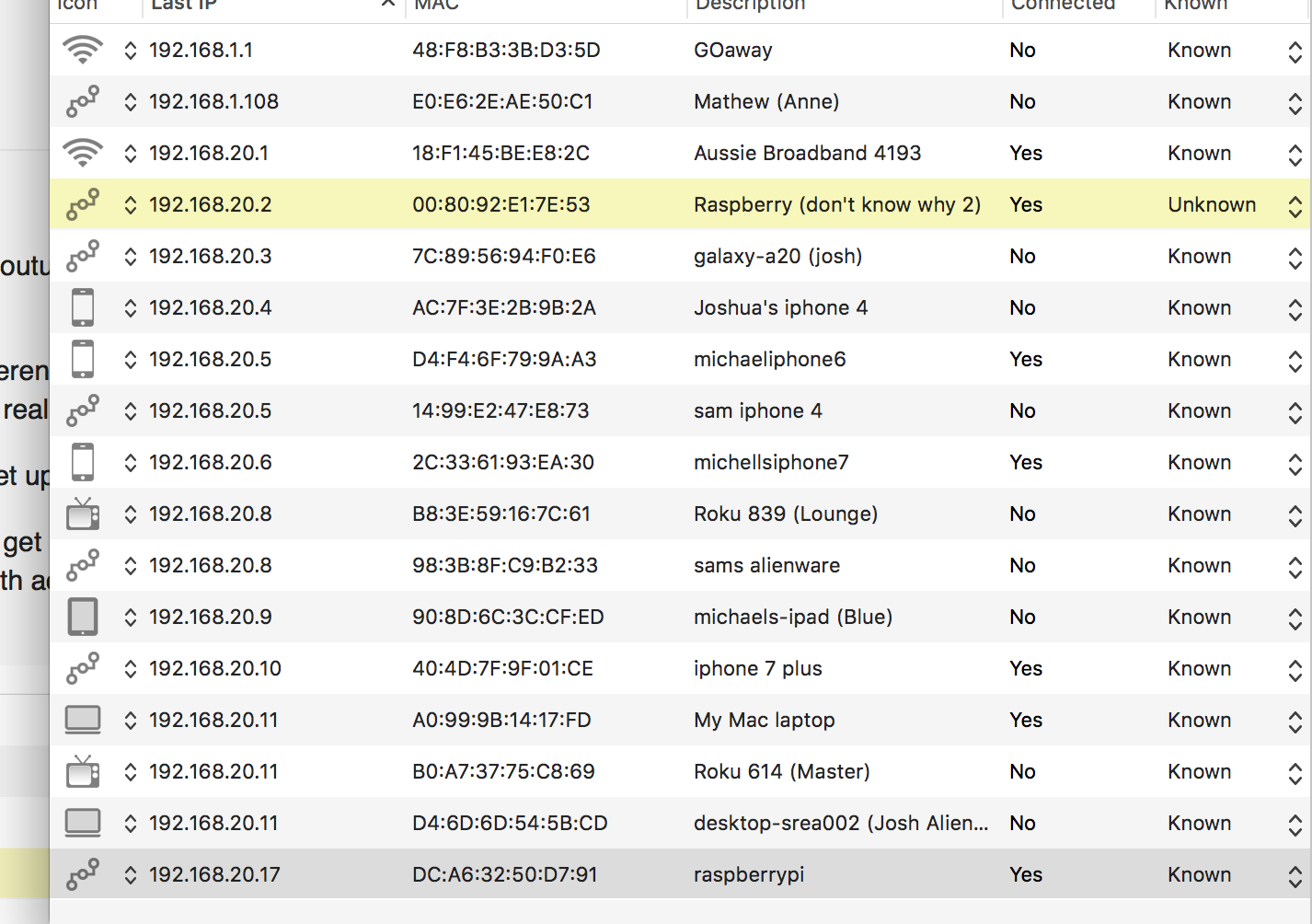

hi, noticed ads still leaking through (on the roku youtube) tried various things - found there was 2 ip addresses?
photo below - but there is 2 different ip with 2 different mac address. it wasn't until i looked at the date and time of first connect (exactly the same) that i realised it was both the raspberry.
photo shows ".2" and ".17", i currently have .17 set up as static ip lease and dns server.
what should i do? if i do it all again i will probably get same result, i don't care about the 2 ip's, just the ads leaking through. it may have nothing to do with ads leaking through. the only other thing i can think of is running pi-hole again and check it is eth0

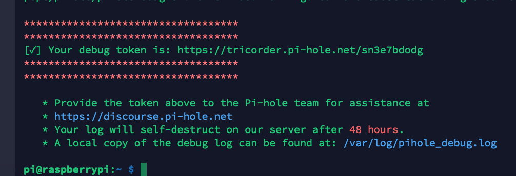

Tools > Generate Debug Log
thankyou, i will leave it in your hands (i really appreciate you looking at it @jfb (love the siamese :smiley: "your debug token is : https://tricorder.pi-hole.net/sn3e7bdodg
and just to be sure i got it correct (have trouble seeing clearly) picture below

Your RPi is likely sporting two IP addresses because it has two network interface controllers (or NICs), one for Ethernet/LAN and one for WiFi/WLAN each.
Each NIC has a globally unique MAC address, so what you see in your screenshot is normal.
