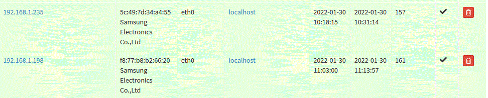

Allocates name as localhost despite showing Warning in dnsmasq core:
This shows ...235 hard wired connection
and ...198 wirelss connection
The DNS error shows whichever is connected.

not giving name localhost.lan to the DHCP lease of 192.168.1.198 because the name exists in /etc/hosts with address 127.0.0.1
This is a known misbehaviour of some Samsung TV sets.
Your offending TV is requesting to be given localhost as a name during DHCP lease negotiation.
IIRC, some reported to have been able to overcome this by configuring a name in the TV set that didn't contain any of a list of specific characters. You may want to consult Samsung's support for additional details.
To compensate for that misbehaviour, you may also try to explicitly assign a hostname for the DHCP lease for that specfic device via Pi-hole's DHCP configuration.

Just added the correct hostname name against the MAC address, seemed to do the trick.
