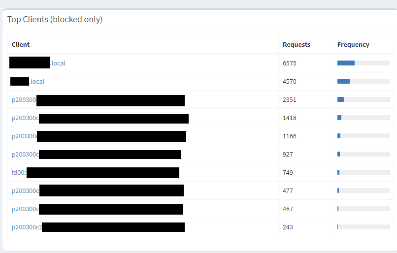

may I also ask a question regarding this topic?
I hope its not completely the wrong, but for me it sounds like a similar thing.
Is there a way to give all thos cryptic hostnames the real name?
All IPv6 devices are only listed with a long cryptic ID.
All Ipv4 devices have the correct name. For example: notebook1.local
edit: my pihole is DNS & DHCP at the same time. So it should know the names I think. If I switch to fritz box as DHCP, its working fine. strange....
