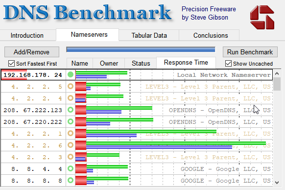

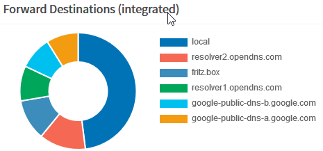

thought about it as a fallback solution even if i dont think that the Google or opendns Service will have any downtime at all... while they are both reacheble pi-hole uses them 50/50 (or 33/33/33)
when i look at this
perhaps its will be the best solution to use the level 3 Servers...
