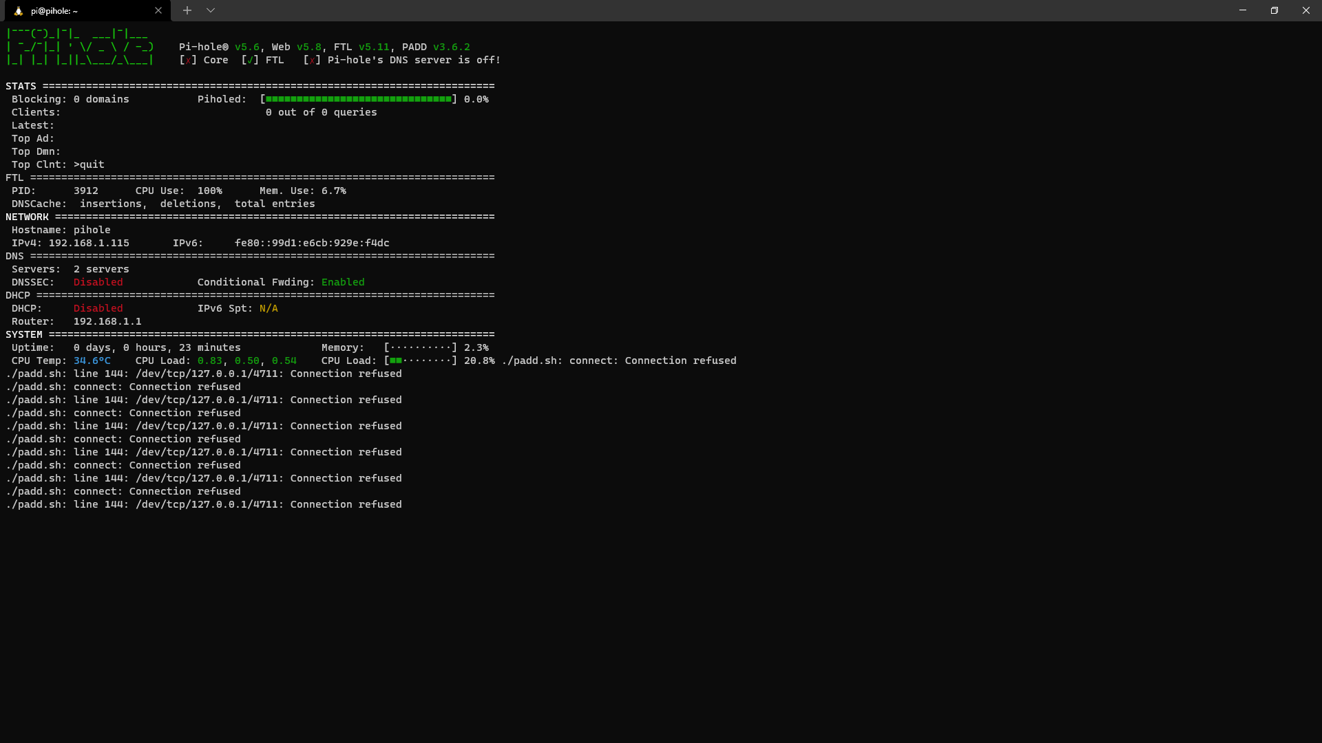

I am also using Padd and I get the following output
https://tricorder.pi-hole.net/tdiSuuIL/
