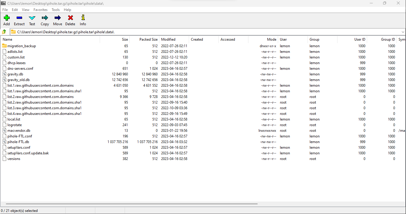

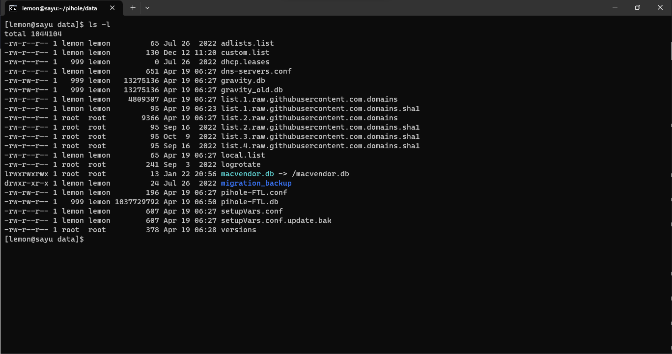

Adding screenshots of the before and after restore :slight_smile:
Before restore in tar.gz
After restore, running

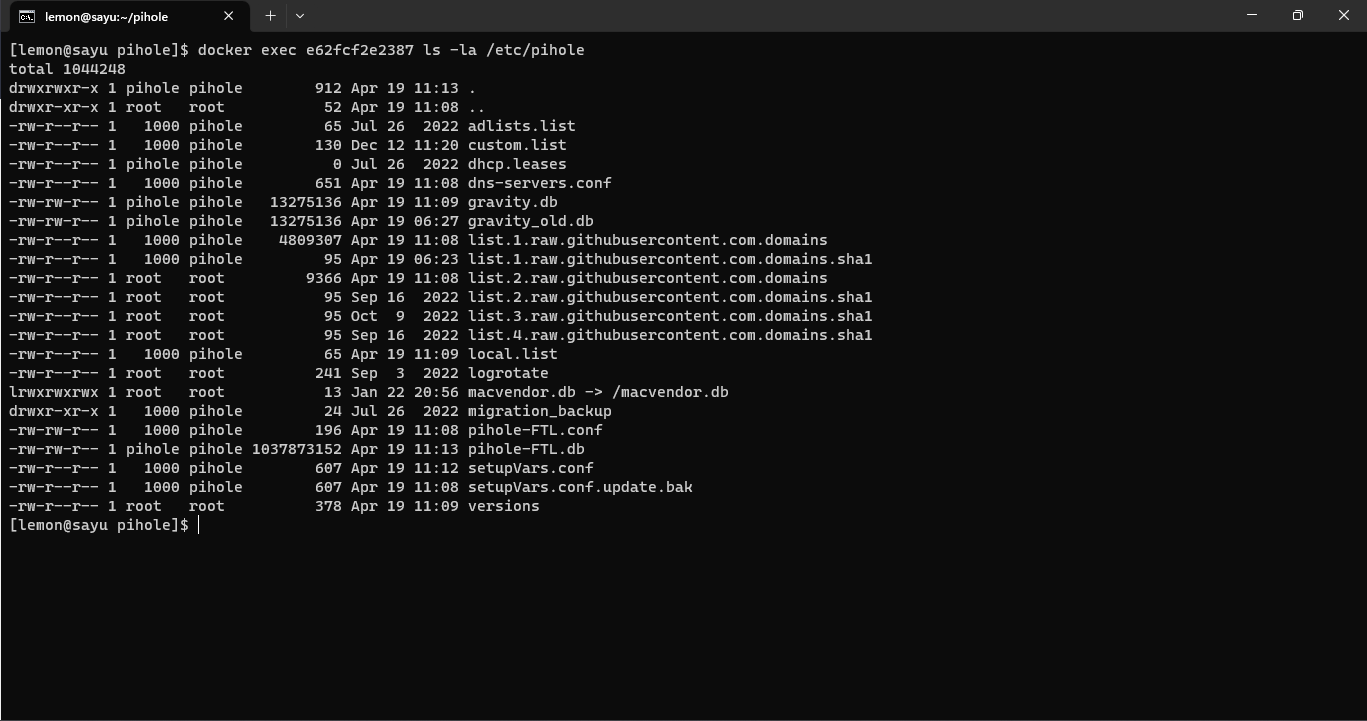

You are showing the contents of ~/pihole/data/. Did you set this directory as a bind mount in the container?
What do you see inside the container?
Correct. I followed the docker compose example on Docker Hub.
Edit: I noticed the password, already changed it.
Use docker exec <container_id> ls -la /etc/pihole to make sure the files are the same.
Here :slight_smile:
They appear to be the same.

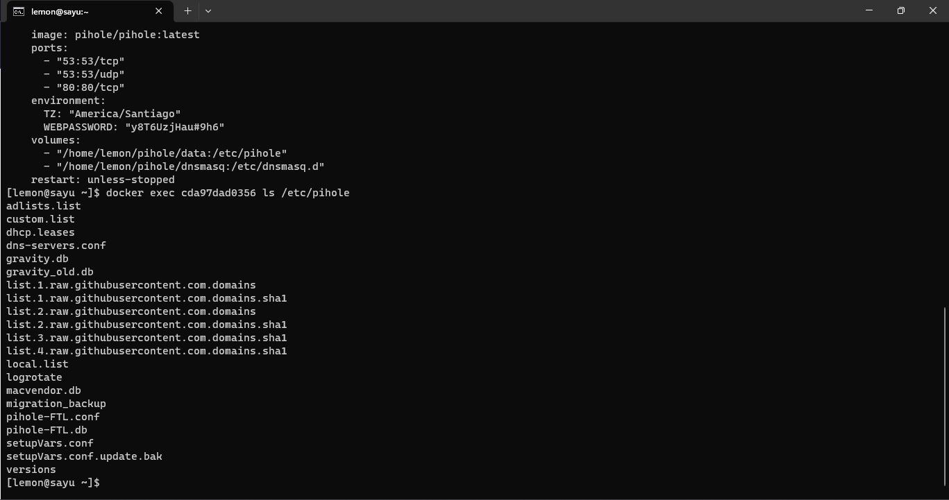

Please share your docker-compose or docker run script.
Sorry for the late response. Here is my docker-compose.yml:
version: "3"
services:
  pihole:
    container_name: pihole
    image: pihole/pihole:latest
    ports:
      - "53:53/tcp"
      - "53:53/udp"
      - "80:80/tcp"
    environment:
      TZ: "America/Santiago"
    volumes:
      - "/home/lemon/pihole/data:/etc/pihole"
      - "/home/lemon/pihole/dnsmasq:/etc/dnsmasq.d"
    restart: unless-stopped

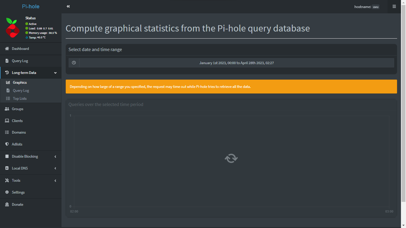

What is the actual output when you try to plot some month of Long-term Data | Graphics covered by your database?
Statistics and logs were reset, that made me suspicious. Now that the file size not only has stayed the same but even increased since the 18th makes me think that is there, just now showing up.
I just tried that, it just continues loading.

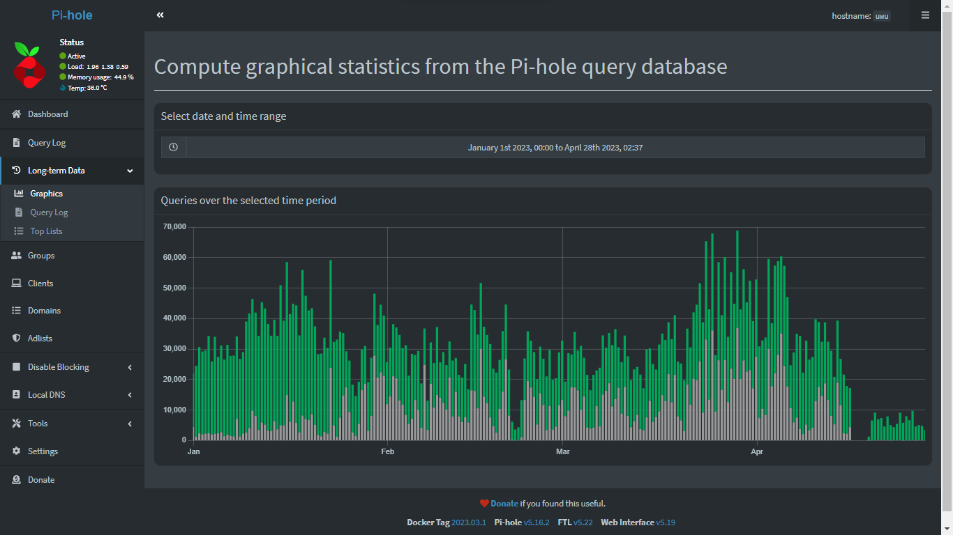

Okay, I deleted the local image, container and Docker network and ran everything again with docker compose up -d and it now shows everything as expected.
The dashboard statistics only cover the most recent 24 hours.
If data from your database would have been older than 24 hours at the time of restoration, the dashboard would indeed have been void of data initially.
Plotting data may take a long time (and even fail due to insufficient memory) if there's a lot of data - so that would suggest there is indeed data retrievable.
