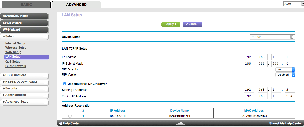

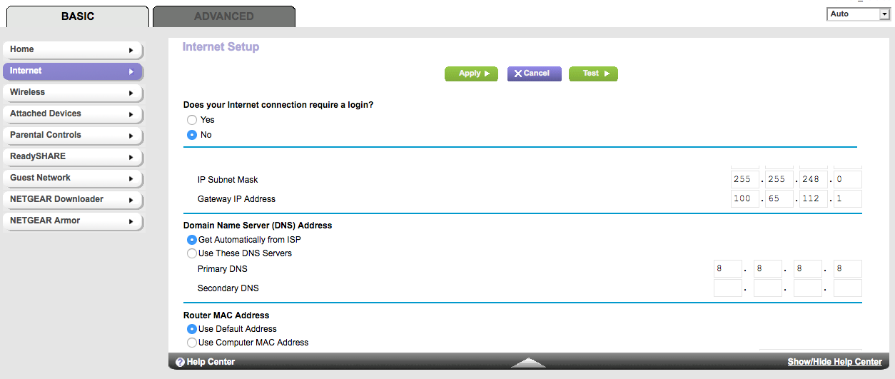

I entered it under Domain Name Server (DNS) Address in the image below.
I'm guessing I should be using the DHCP setting here in the image below?
We had other users reporting their Netgear router's as being not very cooperative when it comes to customising DNS. :frowning:
As for a), it seems you currently have not configured Pi-hole as your upstream DNS server yet (or no longer?).
If your router supports it, b) would be the preferred way.
However, your router's LAN Setup screenshot doesn't seem to expose any DNS related settings to be distributed by DHCP.

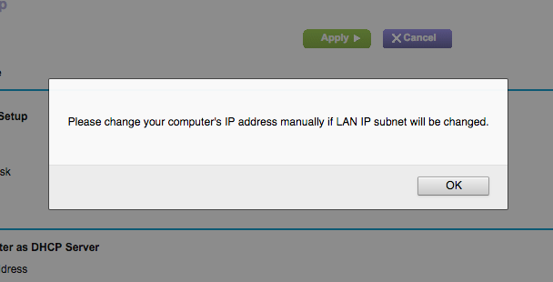

Edit: I get this message when i try to disable DHCP
As your router does not seem to allow b) and seems to be interfering with or suppressing a):
Yes.
EDIT:
I do not know your router, so you'd have to consult your manual or online documentation on how to handle this.
As far as I can deduce from the screenshot, this is a reminder that IP addresses are no longer managed by the router (which is to be expected when you turn of DHCP)
