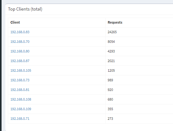

Top Clients - Only IP's shown?
I updated my Pi-hole 5.x to development-v6 yesterday.
Now the dashboard is only showing IP's not DNS names as in 5.x where all DNS names were correctly shown for both Top and Blocked clients.
All client names are visible/readable on DHCP page but not on dashboard...
Any setting I should change to make this work again?

Yes Pi-hole is managing both DHCP and DNS.
Output:
