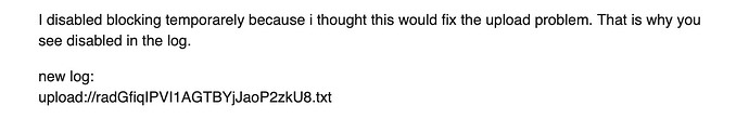

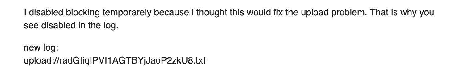

I disabled blocking temporarely because i thought this would fix the upload problem. That is why you see disabled in the log.
new log:
upload://radGfiqIPVI1AGTBYjJaoP2zkU8.txt
There is no debug log - nothing uploaded as an attachment. Here is what I see on my screen from your post:
