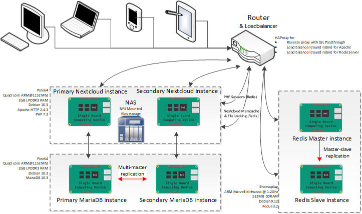

One reason I can think of where MySQL would be preferable to SQLite is when you want to scale or have high-availability by separating the application and the database. 2 Pi-Hole instances pointing to the same MariaDB instance or 2 Pi-Hole instances pointing to 2 MariaDB instance with either 1-way replication (1 master and 1 slave) or 2-way replication (Galera cluster with multi-master setup?)
This is how my Nextcloud setup looks like. If Pi-Hole does switch to MySQL then a similar setup can be done, minus HAProxy and Redis
The only critical component in Pi-hole is the gravity database. Duplicating/synching it periodically seems easy.
