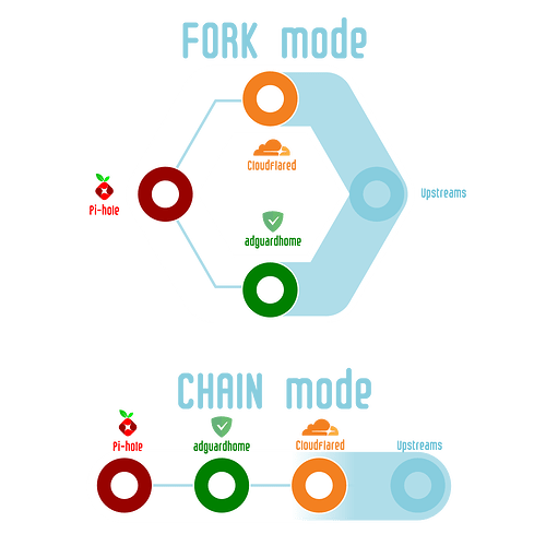

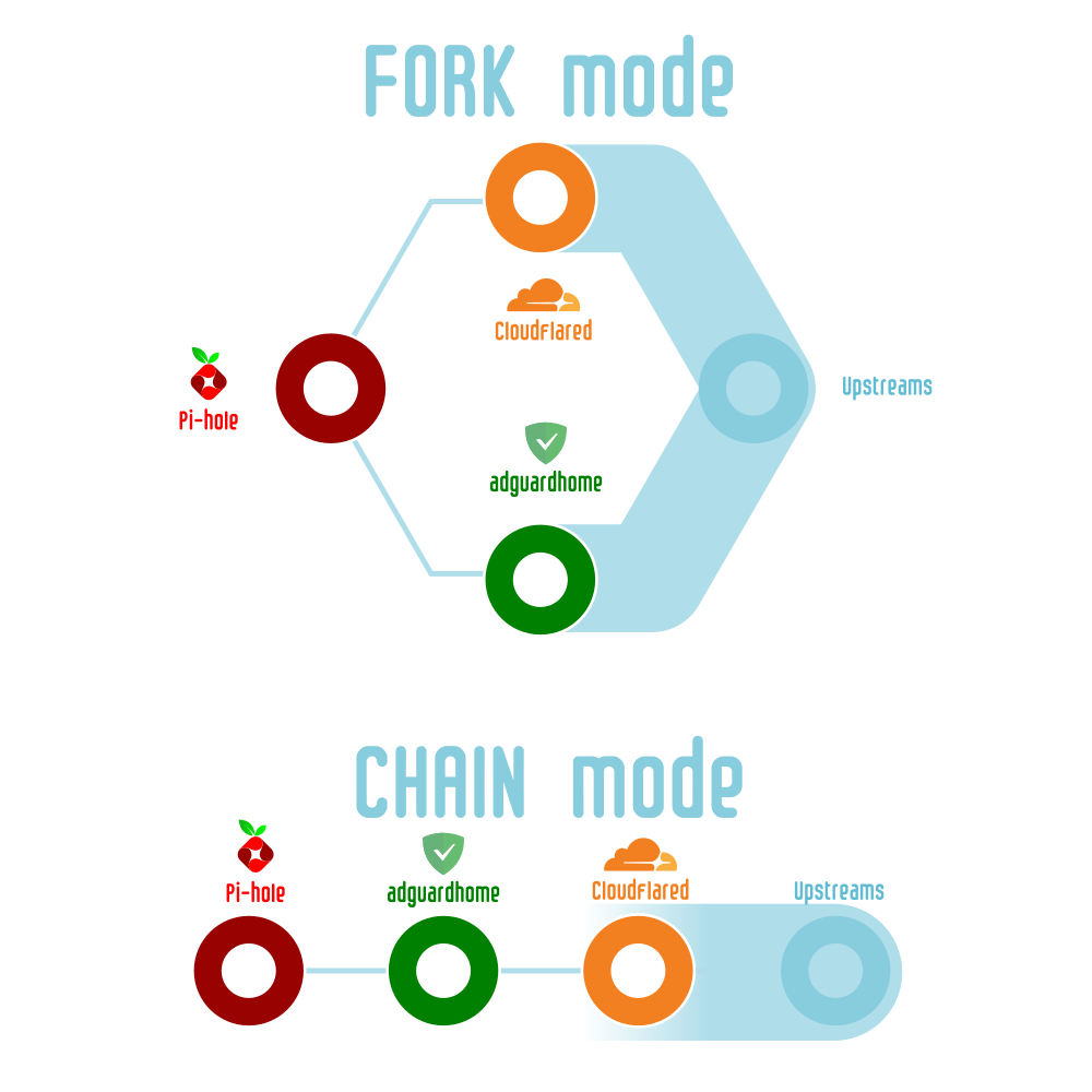

3. The Valve Mechanism: Forked vs. Chained
Forked Mode
You can think of this as “channeling your inner network engineer.” In forked mode, Pi-hole sends DNS requests in parallel to AdGuard Home and Cloudflared. This lets you compare which filters or responds better and debug both independently. You have instant redundancy, and seeing each tool’s quirks side by side is surprisingly instructive.
Chained Mode
Alternatively, “think like a security auditor.” In chained mode, queries are processed sequentially (Pi-hole → AdGuard Home → Cloudflared), so you get centralized logs and a unified policy for privacy and audit compliance. Each DNS request passes through every filter and resolver you set.
How to Switch Modes
You can switch at any time by editing your .env file and adjusting upstream settings in Pi-hole and AdGuard Home. Novices should keep a simple “How to Switch Modes” quick reference near the top of their config.
Forked Mode
Client
Pi-hole (192.168.1.2)
AdGuard   Cloudflared
Chained Mode
Client
Pi-hole
AdGuard Home
Cloudflared

Appendix B: The Valve Switch-O-Matic (Going from Manual to Single Click)
The spirit of this valve design is agility, the system should adapt as quickly as your questions or intentions change. Here’s how you can swap between Forked and Chained mode, from careful manual changes up to one-click automation.
Level 1: Manual Switch (Best for First-Time Setup & Learning)
To switch to Chained Mode:
  1. In .env, comment out the PIHOLE_DNS_2 line.
  2. Restart just Pi-hole:
docker-compose down pihole && docker-compose up -d pihole
  1. In AdGuard Home’s web UI (at port 2233), set its DNS upstream to tcp://192.168.1.9:8877.
To switch back to Forked Mode:
  1. Uncomment the PIHOLE_DNS_2 line in .env.
  2. Again, restart Pi-hole as above.
  3. Set AdGuard Home’s DNS upstreams to public DNS providers (e.g., tls://1.1.1.1, https://dns.google/dns-query).
