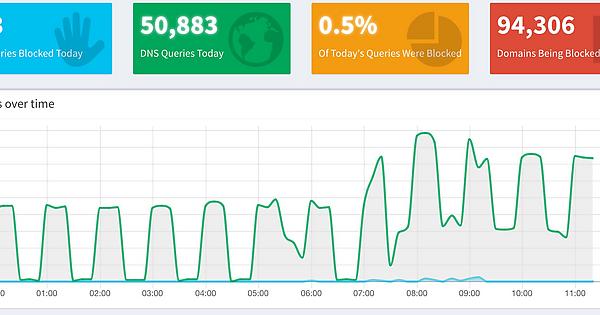

Has anyone else seen activity like this? I've been receiving thousands of DNS requests for the . domain, all originating from China. Any ideas on how to block/prevent this behavior? I'm mostly worried about 50k requests blowing up my memory at this point.
http://imgur.com/a/BG0A6

They're coming in from one or two ip addresses, and using iptables -A INPUT -s <offending ip> -j DROP doesn't seem to be blocking the requests. I'm also unable to blacklist the . domain through pihole.
