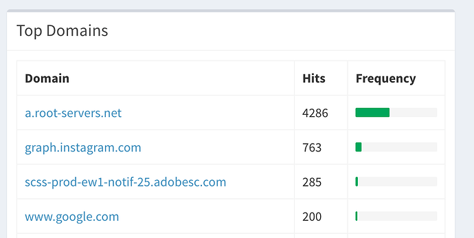

Thousand of A.ROOT-SERVERS.NET domain in my queries

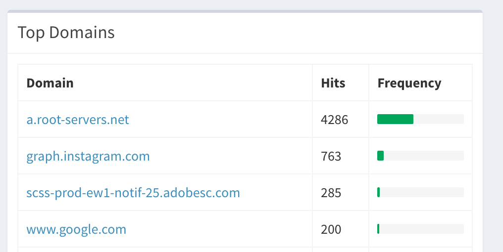

I have a lot of a.root-servers.net calls on my recent queries list and it is the top domain with more of 4000 hits after 2 days.
I am using Pi-Hole installed on a vps and I am pointing my router (tp-link) dns primary address to the vps and as secondary address 8.8.8.8.
Is it normal or I am missing something, I remember when I used a raspberry pi with PI Hole I was seeing all the dns domains calls and not this a.root-servers.net.

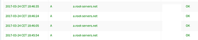

Figure out who it is ?

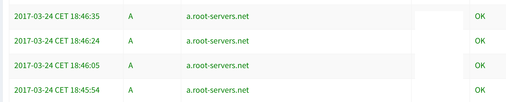

grep -e '^.*query\[A\].*a.root-servers.net.*$' /var/log/pihole.log | awk '{print $8}' | sort | uniq -c | sort -n -r | head -10
Or click on the link:
http://pi.hole/admin/queries.php?domain=a.root-servers.net
Thanks for your help, with the grep I am getting 2 ips one is the ip assigned to me from the provider in my office and the other one is from my home adsl, both router (home and office) are with the vps pihole dns.

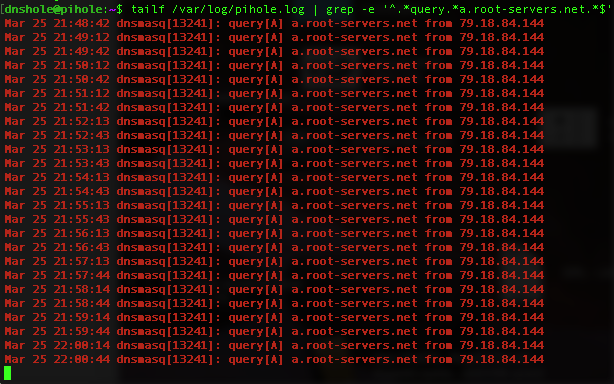

Use below one to tail the Pi-Hole logs:
tailf /var/log/pihole.log | grep -e '^.*query.*a.root-servers.net.*$'
I have an Android Phone that connect on both wifi home/office, but even when the phone is off the request are still in the log.
With the tail log, there is a pattern on the requests every 30 seconds, the ip 79.18.84.144 is the external ip assigned to the router from the adsl provider.

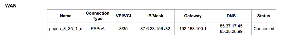

Check the router's WAN DNS setting. That's the DNS server the router itself would use for lookups.

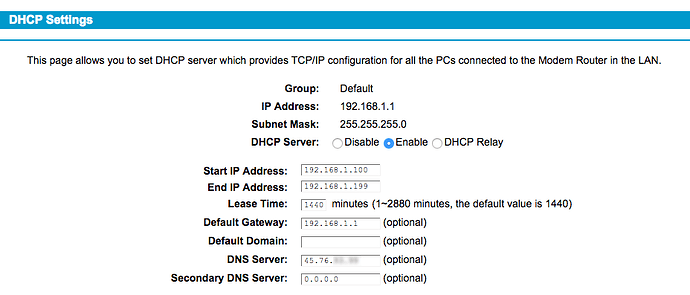

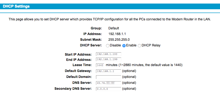

This is my dns setting on the router (wan and dhcp)
IP 45.76.xx.xx is my PI-Hole installation on Vultr vps.

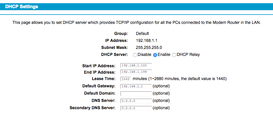

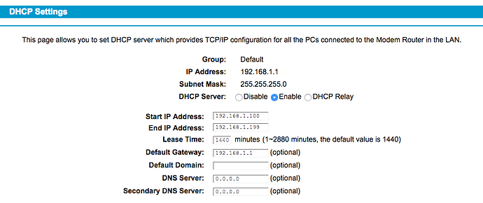

Finally all the A.ROOT-SERVERS.NET calls are vanished :grin:
changing the router setting of the wan to automatic dns (ISP dns are assigned) and using the pi-hole IP address on my vps in the DHCP primary dns setting, fixed the problem.
