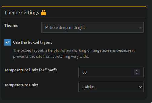

Theme is not persistent
This option is not persistent in docker, but other options are, I have to configure it in docker-compose

Can you please share your compose file?
services:
  pihole:
    image: pihole/pihole:development-v6
    network_mode: "host"
    environment:
      - TZ=Europe/Paris
      - FTLCONF_webserver_interface_theme=default-darker
    volumes:
      - ./etc-pihole:/etc/pihole
    cap_add:
      - NET_ADMIN
    restart: unless-stopped
I can't replicate the issue.
I tested 2 different scenarios:
1) Setting the option via environment variable (FTLCONF_webserver_interface_theme=default-darker):
  • I created a container with FTLCONF_webserver_interface_theme=default-darker. The web interface was correctly started with the Pi-hole Deep-midnight theme (just like in your screenshot above).
  • the option cannot be changed via web interface. This is expected because the option was set using an environment variable.
  • also, the option persists if I stop and restart the container.
2) Starting the container without setting a theme:
  • I created the container without setting a theme (no env var for theme);
  • then I manually set a theme via web interface. The setting was saved and applied;
  • the option persists if I stop and restart the container.
Please explain in which cases the option is not persisting for you.
Also, upload a debug log and post just the token URL that is generated after the log is uploaded. The command pihole -d needs to be executed inside Pi-hole container, using docker exec.
From your host machine, run this command:
docker exec -it pihole pihole -d
