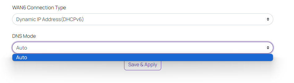

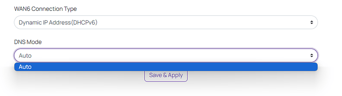

The fiber router (provided by my ISP) uses IPv6, ISP support says there's no way to specify DNS for IPv6 connection.
So the question is: is there a way to still use pi-hole with such a router?

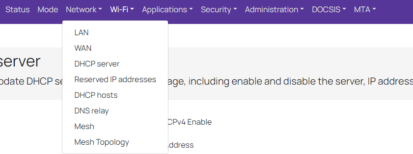

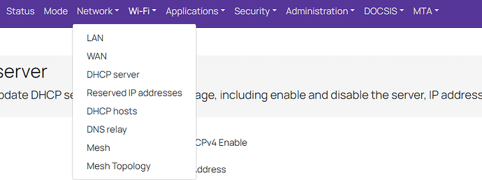

LAN only allows to set up routers IP and netmask.

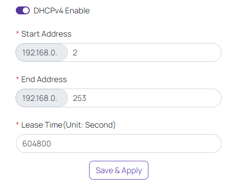

DHCP is just IPs pool
DHCP hosts contains all connected devices and parental settings for them.
DNS relay is on/off radiobutton (still not sure what does it do, because in both positions my devices use my router as a DNS).
And mesh settings.

You could consider to disable your router's DHCP server and enable Pi-hole's.
NOTE that you'd need to configure a static IP on the device that runs your Pi-hole.
Use your Pi-hole host's preferred network management tool to achieve that.
Oh wow. I didn't think pi-hole does that and that is working! Thank you a lot!
