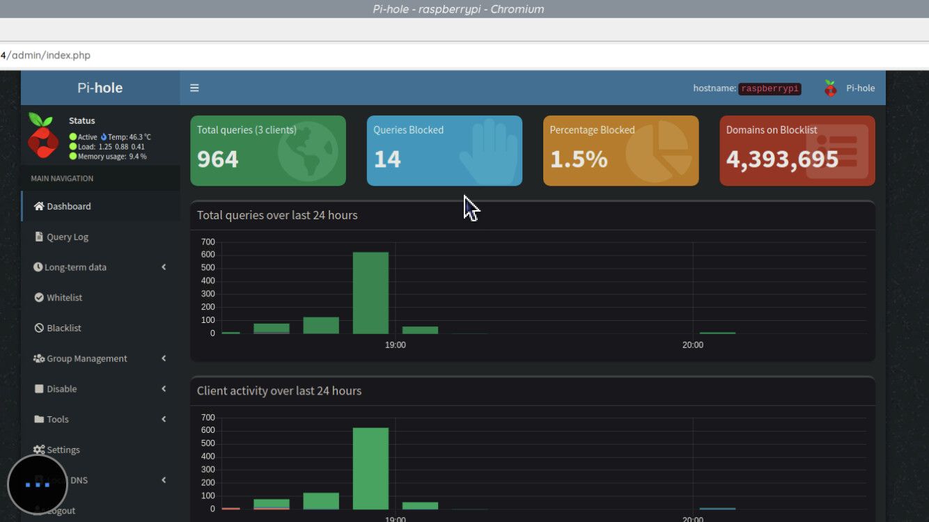

My Pi-hole is stuck at a number and is not increasing or decreasing I tried updating, resetting the whole system but nothing has change
You can check in it in the pic below👇

Your debug log shows there are two active DHCP servers (.1 and .186) on the link that your Pi-hole connects to, and one of them is distributing its own IPv4 instead of Pi-hole as DNS server:
   * Received 300 bytes from eth0:192.168.0.186
     Offered IP address: 192.168.0.100
     DHCP options:
      Message type: DHCPOFFER (2)
      router: 192.168.0.1
      dns-server: 192.168.0.114
      --- end of options ---
   * Received 342 bytes from eth0:192.168.0.1
     Offered IP address: 192.168.0.116
     DHCP options:
      router: 192.168.0.1
Furthermore, you should verify your IPv6 settings on your router(s), and probably consider to use an IPv6 ULA address (if your router supports it, range fd00::/8) or a link-local IPv6 (range fe80::/10) instead of the GUA IPv6 (from 2000::/3 range) you are currently using.
For such a GUA address, both its IPv6 prefix as well as its interface identifier parts may change sporadically or regularly, and Pi-hole needs a stable IP address.
