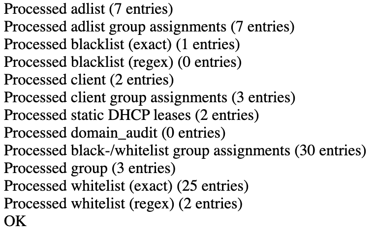

Restoring the data to a second pihole shows me the following:
Processed adlist (55 entries)
Processed adlist group assignments (55 entries)
Processed blacklist (exact) (34 entries)
Processed blacklist (regex) (9 entries)
Processed client (0 entries)
Processed client group assignments (0 entries)
My view: not all the data is being backed up. Is there a reason for this?

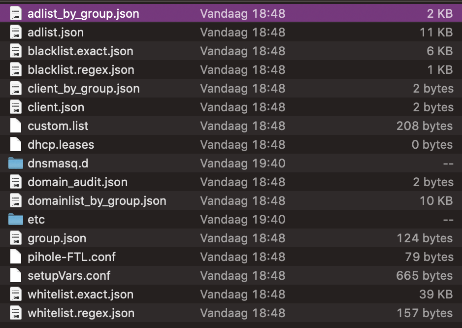

Have you examined the export file and verified that the relevant lists were exported?
Good one. I just did and indeed the missing data does seem to be in the downloaded backupfile.
When restoring I selected all the tick boxes ("restore all").
