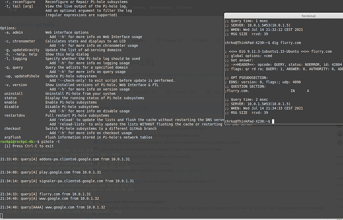

Mine are showing in color:
  Pi-hole version is release/v5.4 v5.3.1-49-ga52a5e7e (Latest: v5.3.1)
  AdminLTE version is release/v5.6 v5.5-44-g4e1f7c2 (Latest: v5.5)
  FTL version is release/v5.9 vDev-c5f4931 (Latest: v5.8.1)

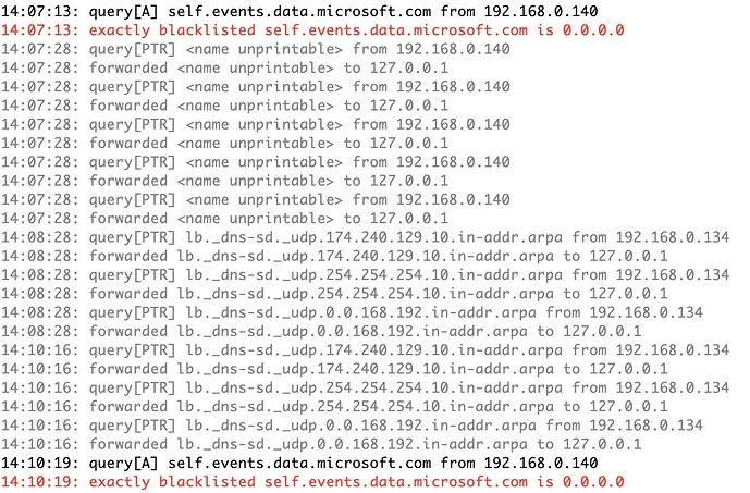

With blocking mode set to BLOCKINGMODE=IP-NODATA-AAAA:
$ dig @192.168.1.10 flurry.com
; <<>> DiG 9.16.1-Ubuntu <<>> @192.168.1.10 flurry.com
; (1 server found)
;; ->>HEADER<<- opcode: QUERY, status: NOERROR, id: 47714
;flurry.com.                    IN      A
flurry.com.             2       IN      A       192.168.1.10
;; Query time: 4 msec
;; SERVER: 192.168.1.10#53(192.168.1.10)
;; WHEN: Thu Jul 15 19:12:51 EDT 2021
;; MSG SIZE  rcvd: 55
Jul 15 19:13:38: query[A] flurry.com from 192.168.1.10
Jul 15 19:13:38: gravity blocked flurry.com is 192.168.1.10
Output was not red.
And if I set blocking mode to NULL I get 0.0.0.0 in the output as expected and it's coloured red.
