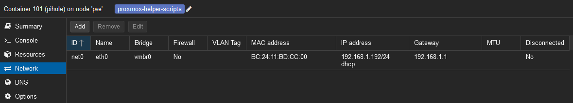

As you intend to run Pi-hole as a DHCP server, you sure did define its proxmox environment for a static IP address, didn't you?
Definitely. My Proxmox host has a static IP:

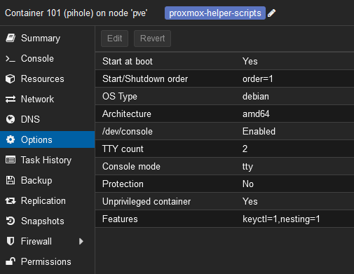

And has almost all default options:
Other than that I configured it to start up first with no delay, should the host ever go down.
