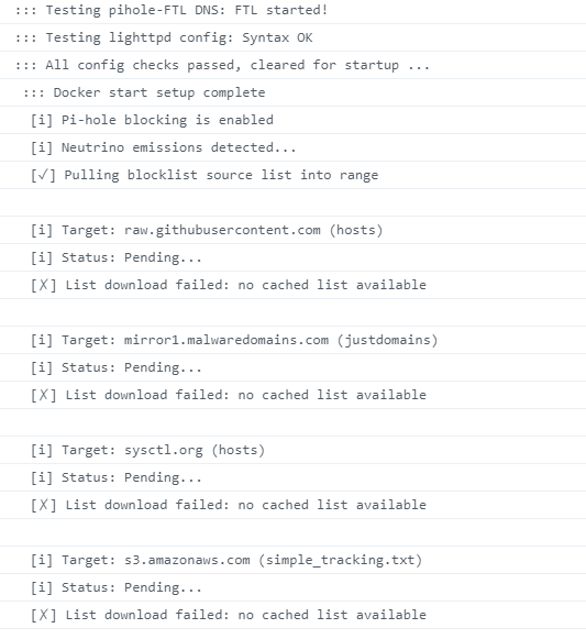

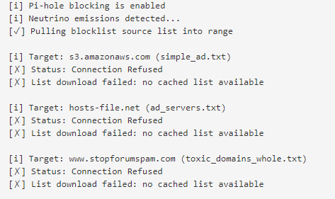

hello all.. i just installed a Pihole/Docker on synology 718 and for some reason i cant get the gravity to updated..
im sure i missed something .... i just dont know what.
i have tried many things but nothing works.. whatever i could fine online but no luck
Any help is appropriated.
I have tried to reinstall and same thing happens.. everything works but the gravity updated..
pihole_error2
token: c92kxfyszm
any ideas??
Everything else works but blocklist source updated,,,,

Unfortunately there is gonna be some hunting on your part as the docker container does not seem to be able to go out. It could be anything from a firewall issue inside synology to not setting up proper IPs when creating the image. If you have the firewall on i would look into that first if everything has been setup properly.
When i SSH into the container I can nslookup url etc. I can web log in. I can manually add domain to block list etc . What port is gravity using to get it's updates... Is it something out of the blue?
