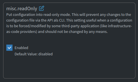

I guess we will go with the misc.readOnly kind-of-option. Please try if my first attempt does what you expect when you use FTL from branch new/misc_readOnly instead of development-v6
This is how the option looks like on the web interface (all settings) but you obviously cannot enable it from here:
grafik
Wow you're quick! I tried it out and it works like a charm, if I run my ansible playbook it doesn't report any config changes b/c FTL didn't overwrite the config. So it definitely works!
