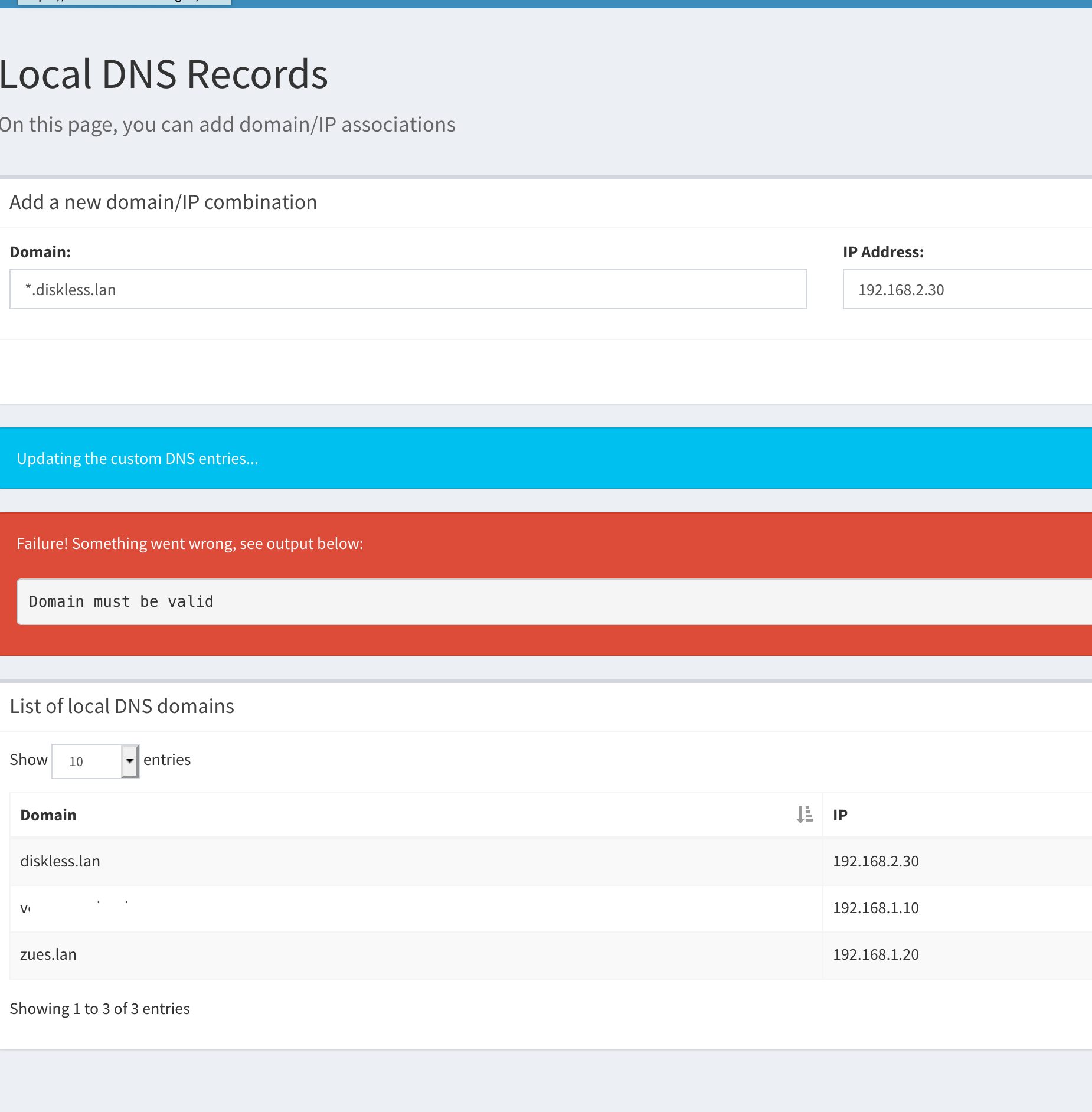

+1 on this. Pihole 5 supports the ability to add local dns, but it can't support wildcard dns records. Here's a screenshot for an example:
