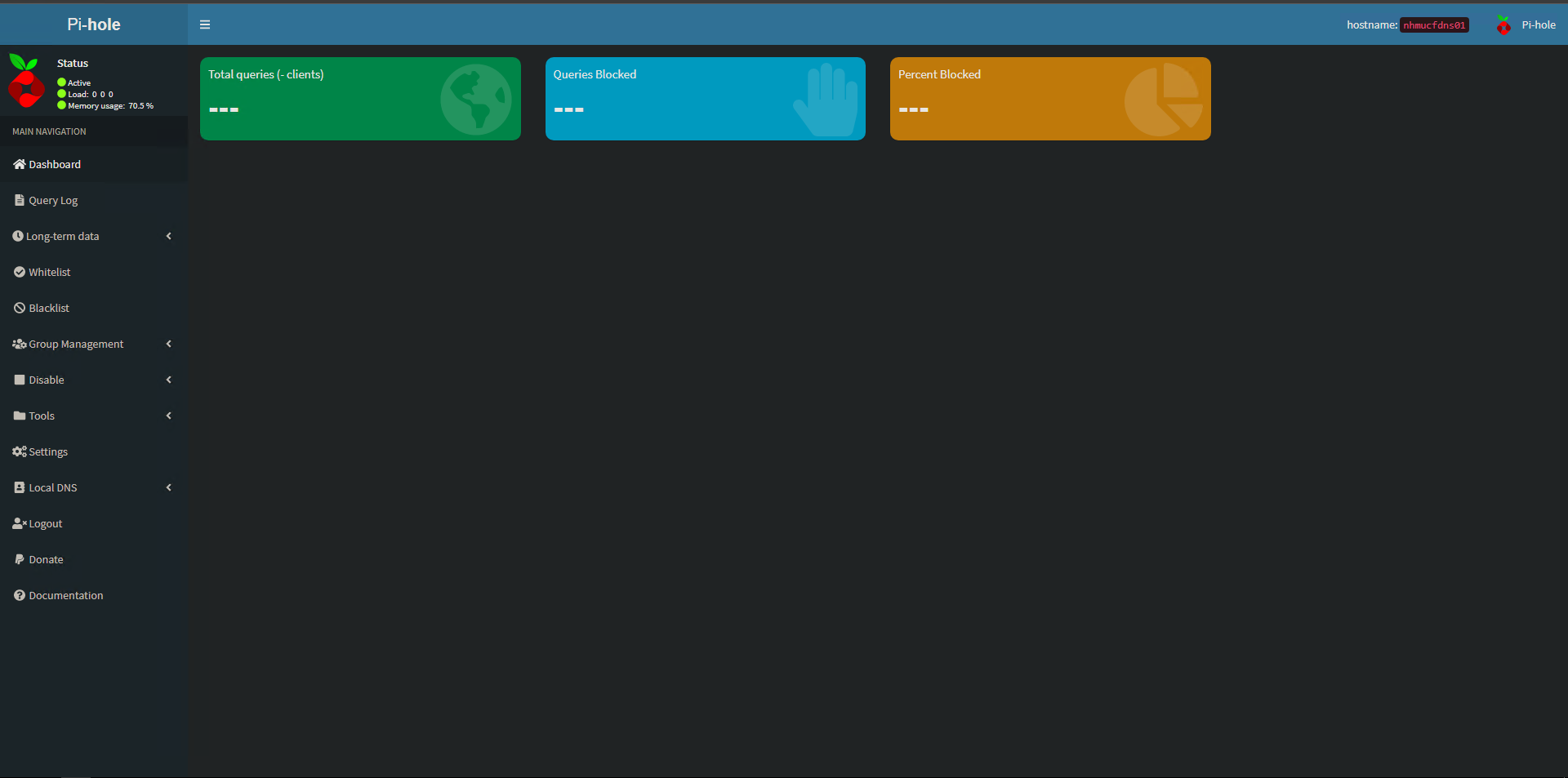

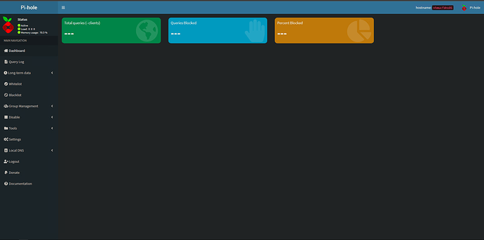

Everything works except the statistics page (port 4711)

Thanks for the post. I checked it and the issue on the web is still present.

However the connection to the sqlite seems indeed broken, as the blacklist, whitelist and the group management are empty. The latter even throws the ajax datatable error 7, so there must be indeed something between php and sqllite wrong.

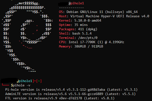

Thanks for all the help, fellas. I managed to bork my previous Ubuntu Pihole, so i decided to take this opportunity to reroll with Debian 11 (bullseye). Fresh VM, freshie Pi-hole install... just skipped the initial OS check and things went mostly smooth.
