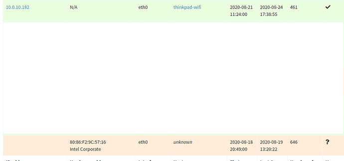

The one stubborn device still re appeared with two entries. Will flush the table and re-enable DEBUG ARP, EDNS0 and DATABASE.
You do not need to flush, just enable the debug messages and check if FTL is still receiving the MAC addresses through EDNS. If it doesn't, the problem is elsewhere. If it does, then something is broken on the Pi-hole end.
... too late, already did.
I'm actually not 100% confident in my router that it sends the MAC very often. Inspecting the log, it seems it send the MAC for one device a few times and later (or on some kind of trigger?) the MAC of another device - even though both sending DNS queries constantly.
But I can say, everything is working fine now. All clients show up with their corresponding MAC address and no duplicates.

Did a tcpdump on the device hosting pihole for everything on port 53
All request that have been forwarded from the router contain EDNS0 information (subnet+ MAC), except my wireguard client and router's localhost (both only IP/subnet)
Still have to figure out, why my laptop, both on wifi and eth still sends requests directly to pihole ignoring the DNS server address it gets via DHCP.
Maybe you edited /etc/resolv.conf (or similar) manually or setup something that does this.
Sot he conclusion is that all packets contain the data but FTL is not seeing them every time? This is ... surprising. How about the log in /var/log/pihole-FTL.log? Are there records for **** new UDP/TCP querys without EDNS(0) information?
Bingo!
I totally forgot about it. It was not directly edited but via systemd-resolvd as a workaround to change the DNS server order for my wireguard interface...
No. Conclusion is: Pihole is doing fine. But one client with two interfaces ignored the DHCP DNS settings and were still sending requests directly to pihole instead of the router, which would then had added EDSN0 information.
But why does this client then show up as mock-device? Because it was able to connect to Pi-hole but separated into a VPN caused Pi-hole to see queries from this client once through the router (with MAC added) and one directly (but without visible MAC address)?
That was what I wanted to figure out/reproduce.
