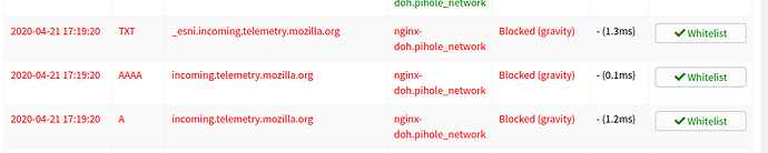

So I went along and implemented it. We now reply to all _esni.X requests with NXDOMAIN given X is blocked for any reason (exact or regex blacklist or due to a gravity list match). The reply type will always be NXDOMAIN regardless of the configured blocking mode.
Please test it carefully! Run
pihole checkout ftl new/block_esni
to get the version of FTL containing this new feature. Note that, while the new _esni blocking defaults to being enabled, however, it may be disabled by setting
BLOCK_ESNI=false
in /etc/pihole/pihole-FTL.conf. I don't think there is any reason for why it would need to be disabled, however, it certainly won't hurt.
And just to confirm, I've been running this since you pushed the test branch 8 days ago and it's worked perfectly and given me no problems in that time.
