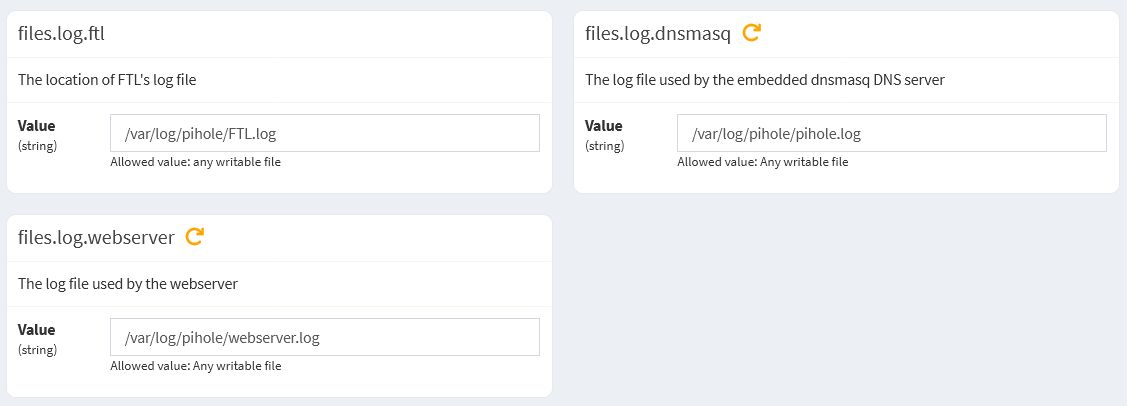

  • LogsDirectory=pihole makes sense as well, since all logs have been moved to that subdir, and makes related prestart steps obsolete.

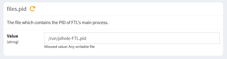

  • RuntimeDirectory=pihole at the moment would be unused, since /run/pihole-FTL.pid is the PID file. But that should be changed, moving it to /run/pihole/FTL.pid or so, or removing it entirely. Actually with systemd, no PID file is needed (unless used for something important internally). Same as with /etc/pihole, /run/pihole then would need to be added to ReadWritePaths, if FTL itself shall be able to create the PID file.

Unless the user decides to change the logs location using these options:
I'm not saying it is a bad idea to use the suggestion. I'm just saying that Pi-hole logs can be placed in different directories using these options.
I don't remeber exactly where it is used, but FTL needs the PID file. There is even an option to define its path:
This is another important thing to pay attention.
Oh, indeed the prestart script checks the settings for this and also PID file: pi-hole/advanced/Templates/pihole-FTL-prestart.sh at 5a23c9c366b465438871693f3c4f172b4e4d4fa1 Β· pi-hole/pi-hole Β· GitHub
Okay this cannot be reasonably ported to native systemd directives. This also makes ProtectSystem=strict difficult, as one would additionally need to add all custom paths to ReadWritePaths :thinking:. And I know how annoying it is for users to run into permission issues, while UNIX owner/modes are all fine, driving people crazy by times who do not know this additional systemd sandboxing :sweat_smile:.

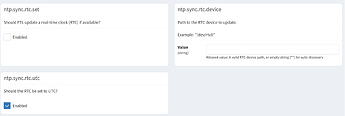

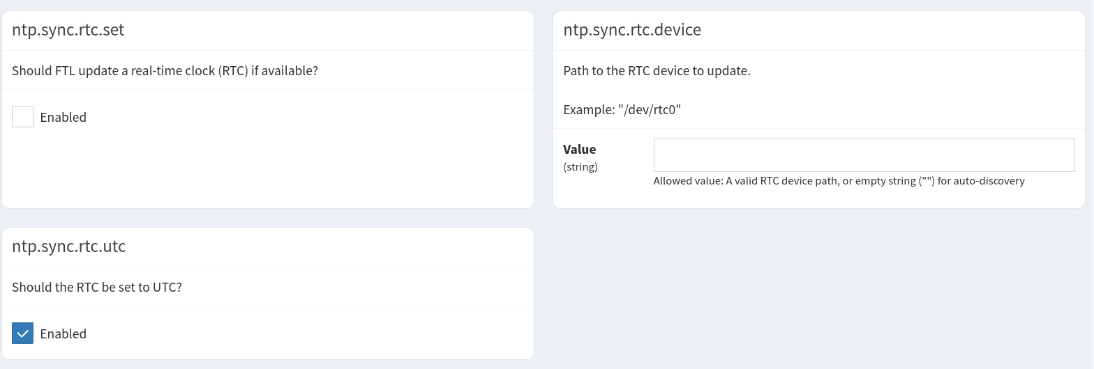

How would ProtectClock work here? I am not using the NTP server functionality of Pi-hole either, but if you were using it, would Pi-hole not manage the host clock as well? In which case you would need to allow access to the clock in order to modify the time etc. Is my understanding wrong?

Yes, this would definitely cause problems with the RTC related NTP functionality (Which access the RTC via /dev/efirtc, /dev/misc/efirtc, /dev/rtc0, /dev/rtc, /dev/misc/rtc), or other user specified device)., not just on a Rasberry Pi, but on any other system.
Edited to add, I believe that these are the only hardware devices present in the FTL source, other than pseudodevices like /dev/null, /devurandom etc. So this could be dealt with by the following:

Thanks, this would also preclude ProtectClockfrom being used if the option to update the clock is ticked. Devices can be whitelisted with DeviceAllowbut that may not be workable in such a case.

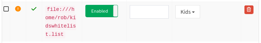

Setting Protecthome=Yes also interferes with locally stored blocklists/allowlists.
But Protecthome=read-only would allow these files to be accessed while offering protection to the contents of /home from alteration.
