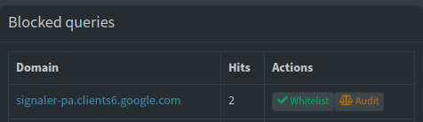

I’d like to request a change to how queries are handled when “database is busy” Currently if the database is busy a query becomes blocked and shows up in audit log for blocked queries. As someone who regularly checks audit logs and sees a legitimate query blocked my first instinct is to check which adlist blocked the query so I can report false positive. Instead of blocking queries and showing them in audit log as blocked, maybe mark them as rejected. I’d like to think a block query is one based on an adlist or filter rule. A rejected query is based on a database is busy.

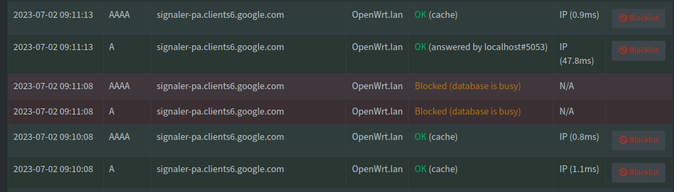

I'm confused now. So in "/etc/pihole/pihole-FTL.conf" I added "REPLY_WHEN_BUSY=DROP" and i'm still showing as blocked in query log and audit log
Screenshot from 2023-06-27 09-53-34
Screenshot from 2023-06-27 09-57-40-1

I guess I don't have an answer to that because I never know when the database is busy or able to reproduce a database is busy in order to test the dig command. I just know database was busy at one point and showed blocked in query log and blocked in audit log.

At 09:11:08 you can see a query was received but no reply was sent. I'm assuming its either timing out and dropping the request. I know this isn't the dig command you requested but as mentioned before I simply can't provide that information.

Okay I was finally able to query pihole while the database was busy. Here is the result.
dig @192.168.1.41 api.amazon.com
;; communications error to 192.168.1.41#53: timed out
A timeout means there's no communication between the client and Pi-hole at all. That means there is no question of a reject or a block because there's no actual query happening.
This leads to more questions but they are all at the networking level and not FTL's operation.
